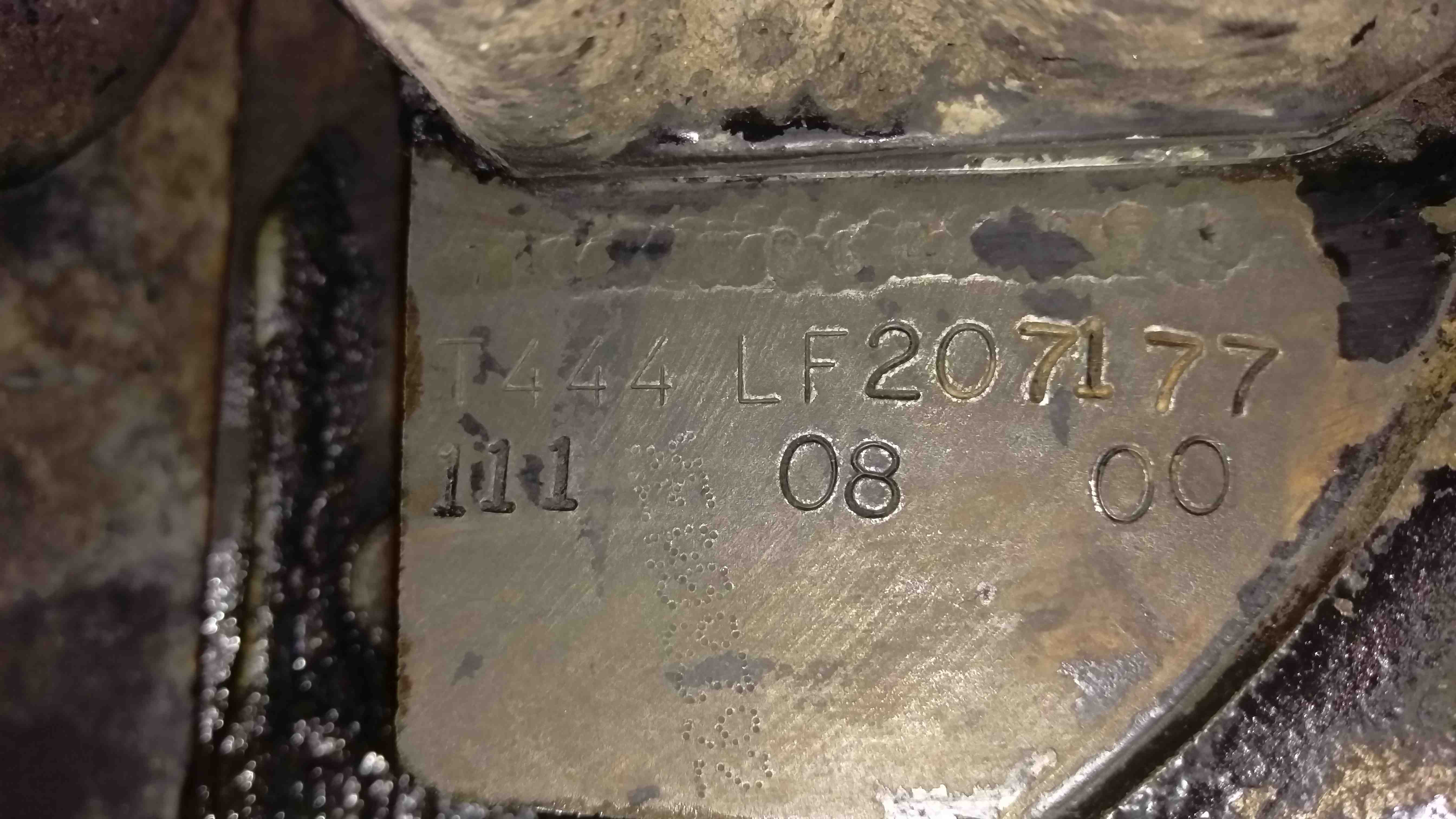

I tried to check my remand Navistar engine serial number, it's been rubbed out. Maybe it came from Chicago? Has anyone seen anything like this? The remand long block was done by Ford under warranty.
Would Navistar remove the original Ford serial number and stamp theirs?

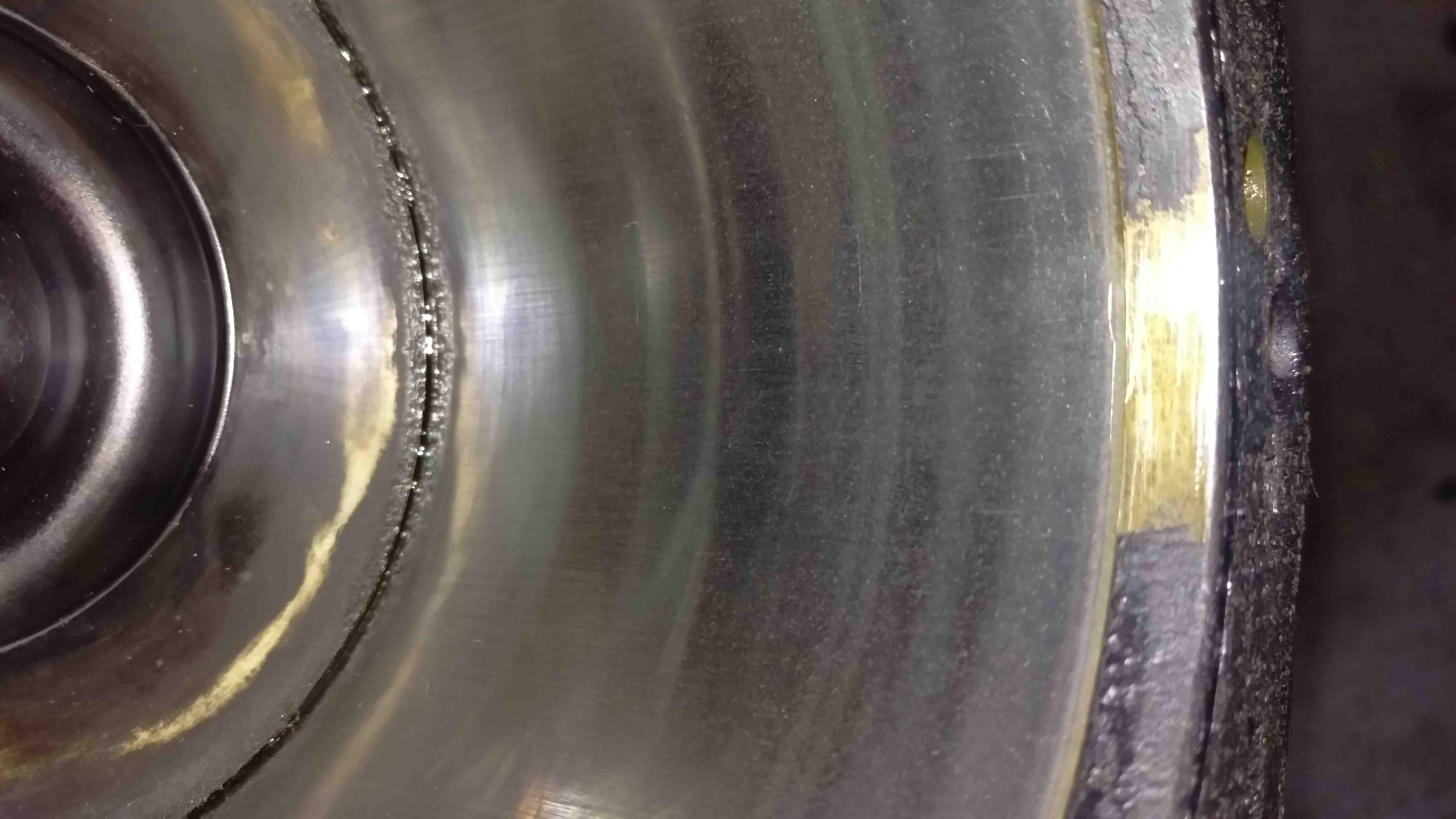

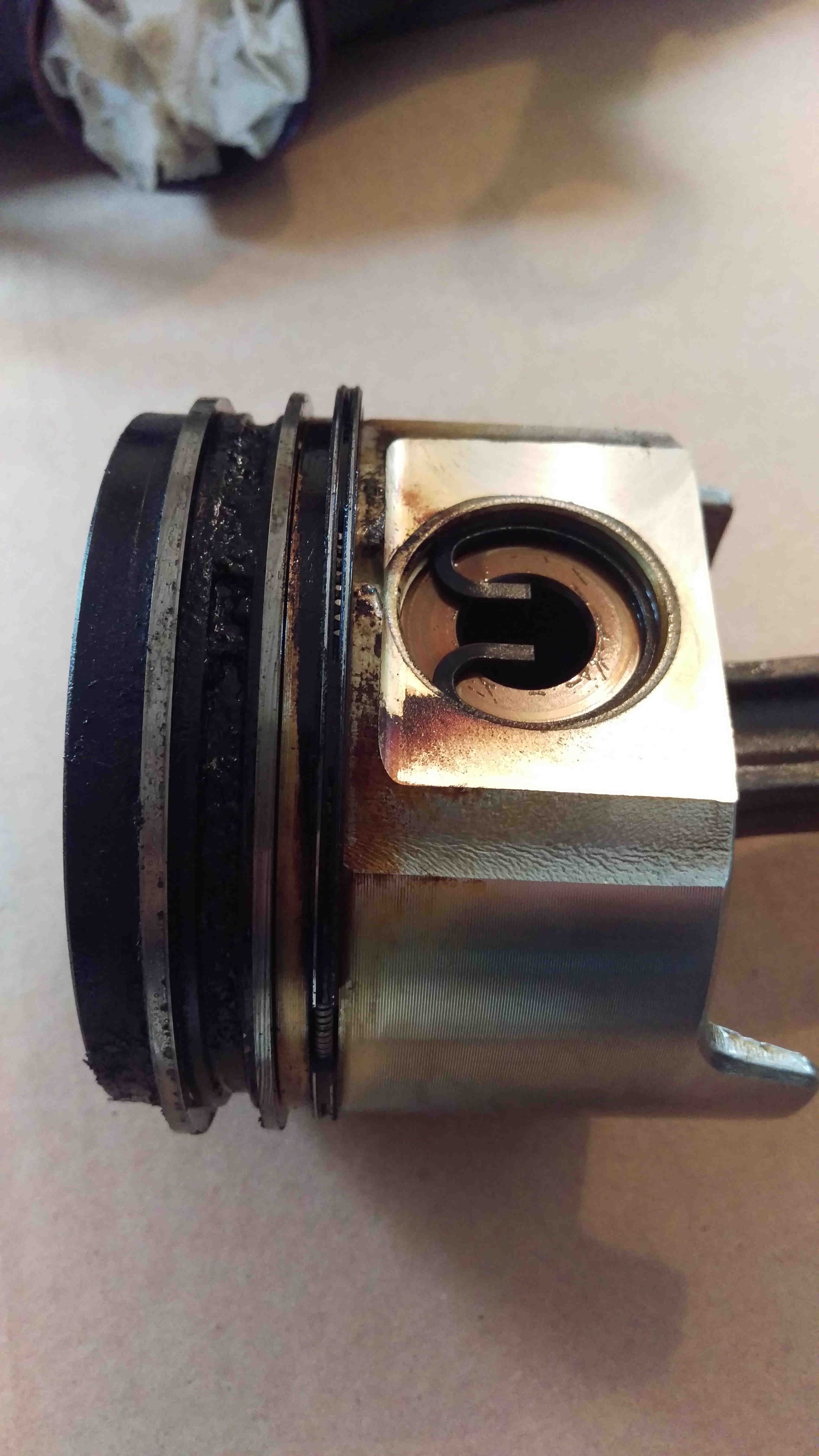

Well I got the heads off today. The pistons are 10 over and all look good from the top. There is NO crosshatch visible. I can feel a ridge on the top of the wall, but it's about a thousandth or two? The engine has ~104,000 miles on it.
For an engine I just wanted to run. I would break the glaze, hand fit the rings and run it. I'm not sure with this thing? What say you?

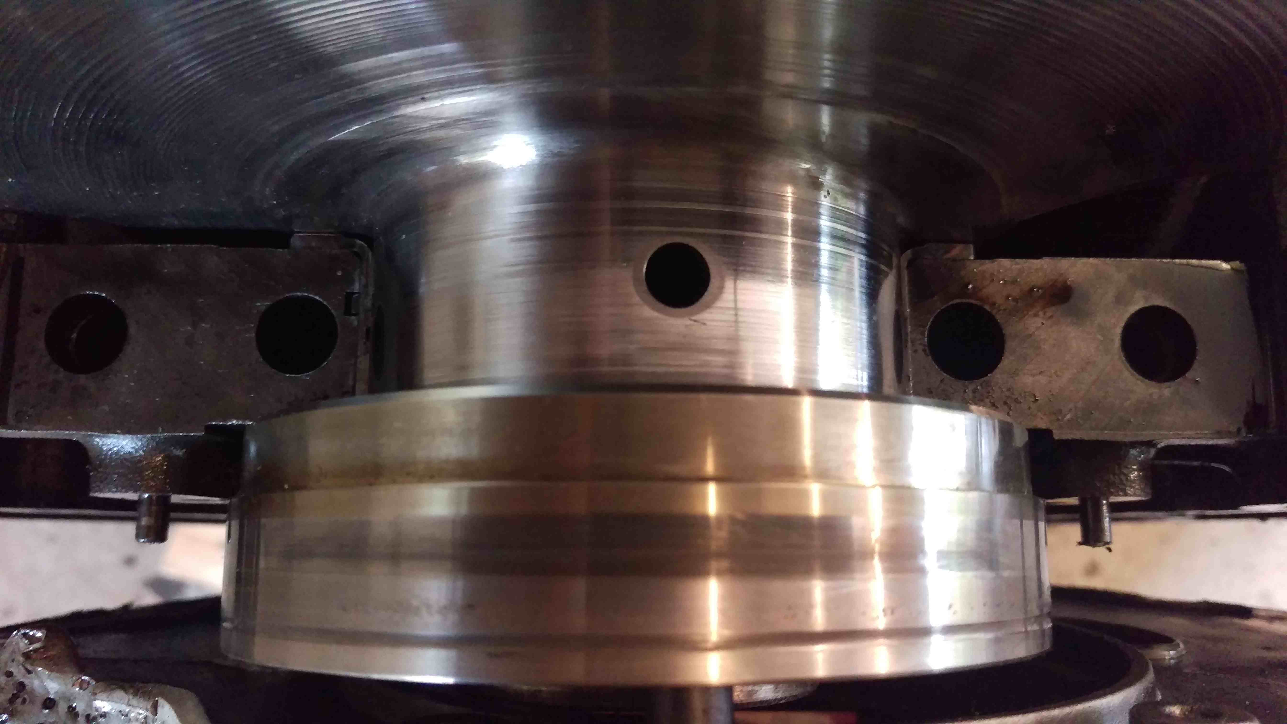

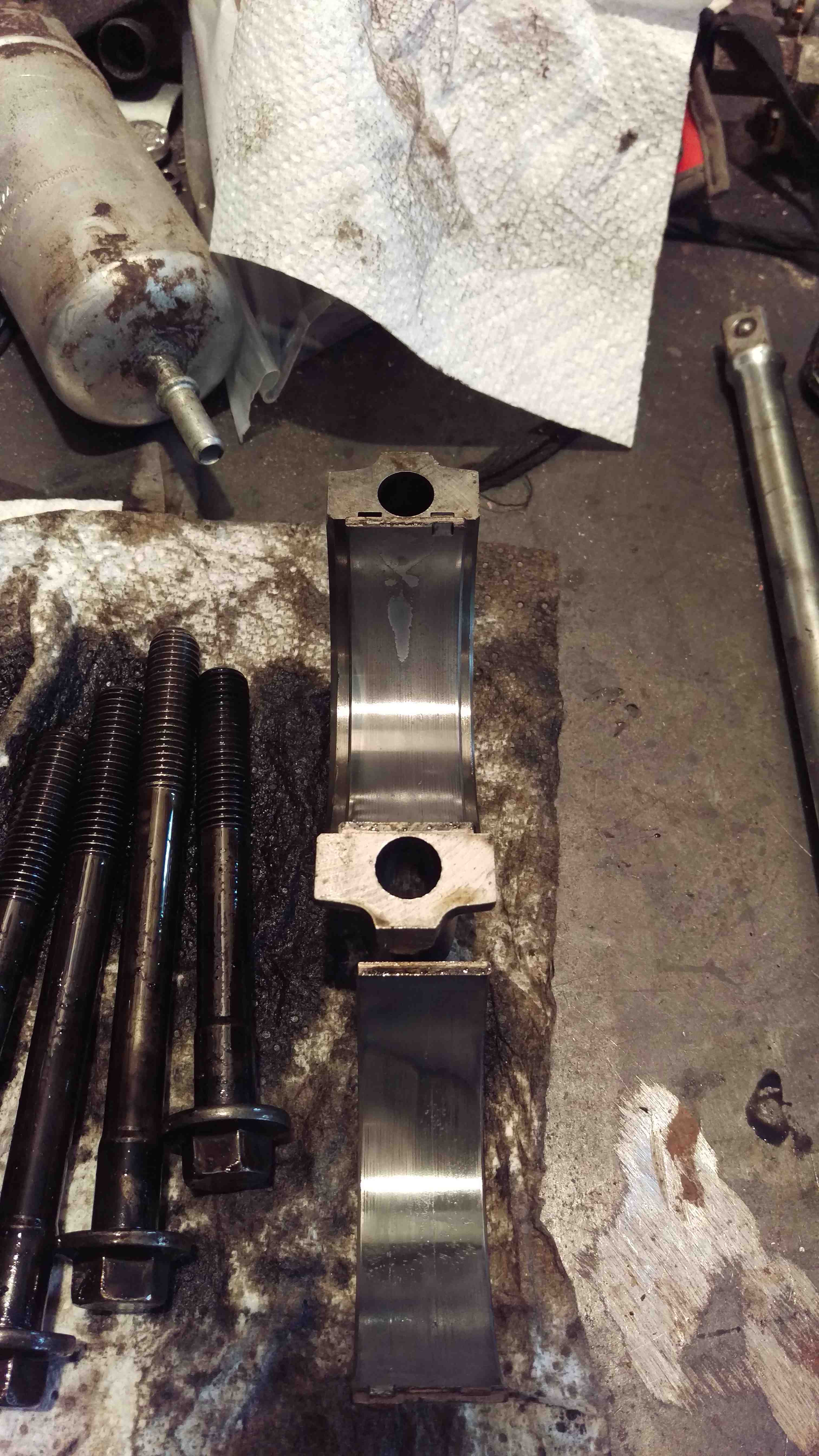

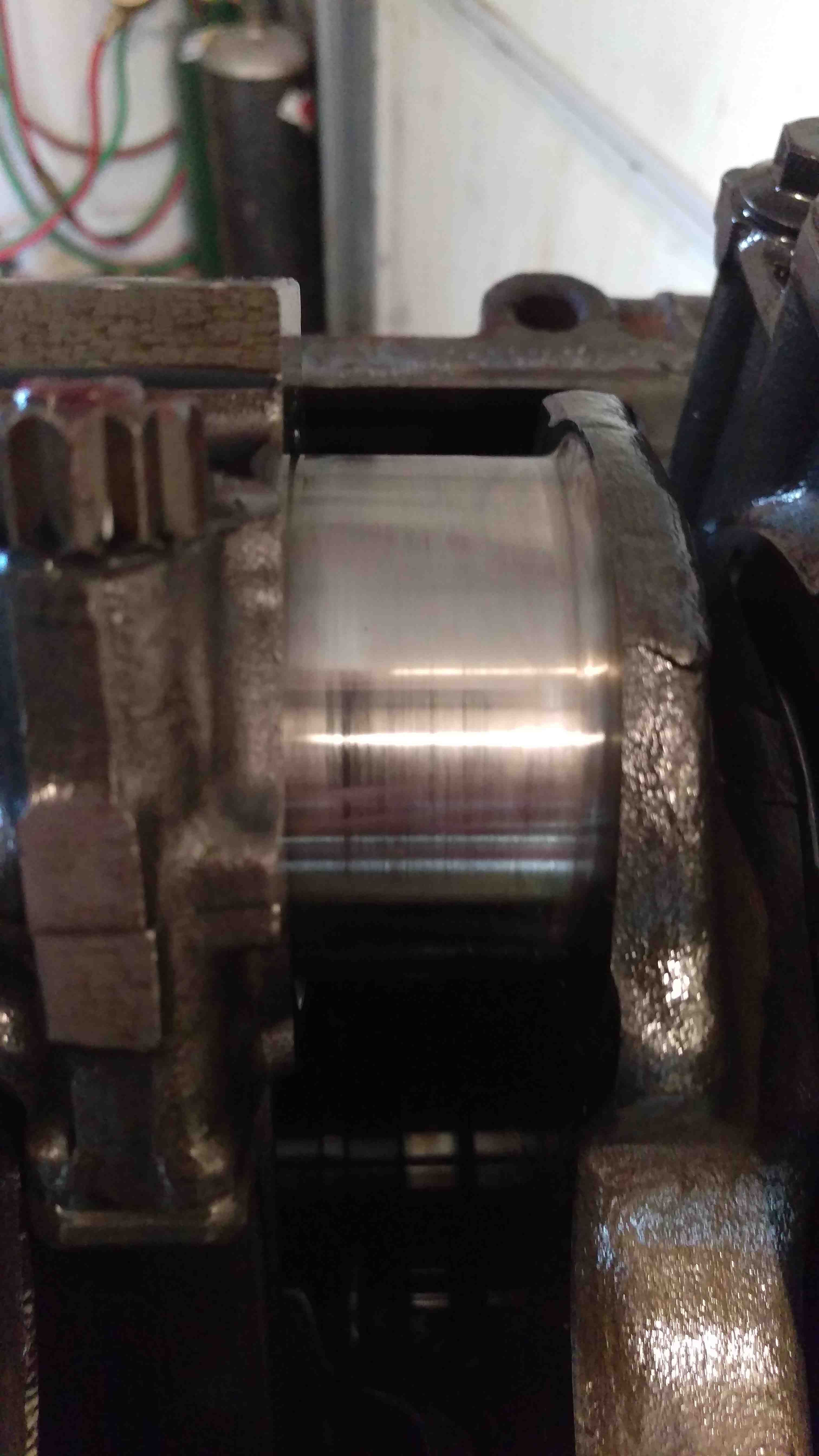

This is what I found under some of the caps.

MeTo
Nov 14, 2015
332
3
A tow pig thread, will I be talking to myself?
I measured the cylinder bores; extremely close to 4.11 for 10 over bores.
I'm hoping I can just break the glaze and hand fit the rings myself?
Tomorrow I will drop it off at the local machinist and get his evaluation. I'm thinking line honing, grind the main/rod journals from 10 to 20 under, cook and magnaflux?
The heads look great. I'm going to give the valves a hand lap and new seals. Replace injector cups just reseal with Loctite 620 for Cat ELC. Not sure if I' going to have them cooked and magnafluxed? Should I do it for peace of mind and insurance?

No crosshatch says high boost/high mileage to me. A glaze-breaker and hone will extend service life, maybe enough for what you want.
An overbore and piston would be better, and at lower hp levels, a basic piston shouldn't add more than 1-1200$ for the machine work and piston. Youre buying rings already, and hopefully balancing the bottom end.
That will get you another 200k, easily, even the 400+ hp range, and probably a lot longer, based on use, lol.

All journals are 10 under and pistons are 10 over.
I checked the top compression ring end gap on number 1 and its at 39 thousandths. I'm wounding if standard rings were accidentally installed?
