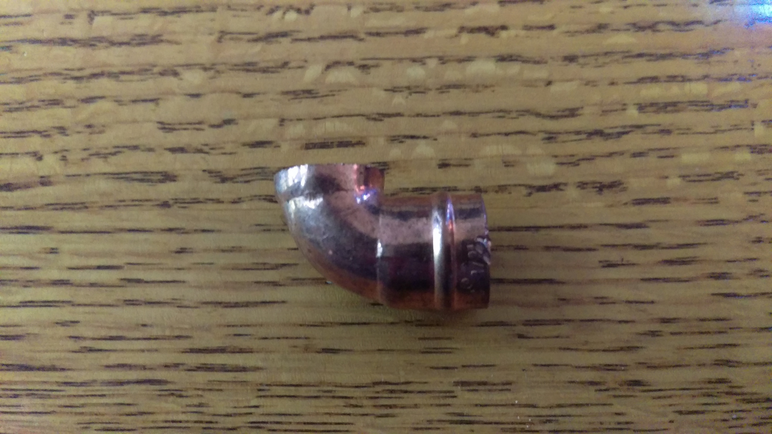

Looking through your recent pics, something caught my eye. Looking at the pic of the back of the block, flywheel area. I noticed a drain tube installed that drains the valley out the bottom with out dumping it in the clutch area first. Did you fab that or does it look like a T-444E part that came on that engine? I was seriously looking at fabbing that up.
An exploding HPOP (lost rear snap ring) cost me a brand new clutch once.
I've never seen on before but I think as along as it is check and kept clear it could be a nice touch.

The valley drain tube is just a 3/8" 90 degree elbow and about 10" of tubing. The elbow is a little unique in that it has a 1/2" fitting rib (see pic) soldered on the outside of the 3/8" elbow solder connection that goes into the valley drain hole. That feature provides a very snug (tapped it in with a hammer) fit in the valley hole. I did put some red Loctite on it to ensure a good seal. Because I extended the tube into the drain hole in the bottom of the block, the tube can't go anywhere. The rear cover on the back of the block also protrudes over the tube, thereby eliminating the possibility of the elbow vibrating out of the valley drain hole. That tube is very secure!
