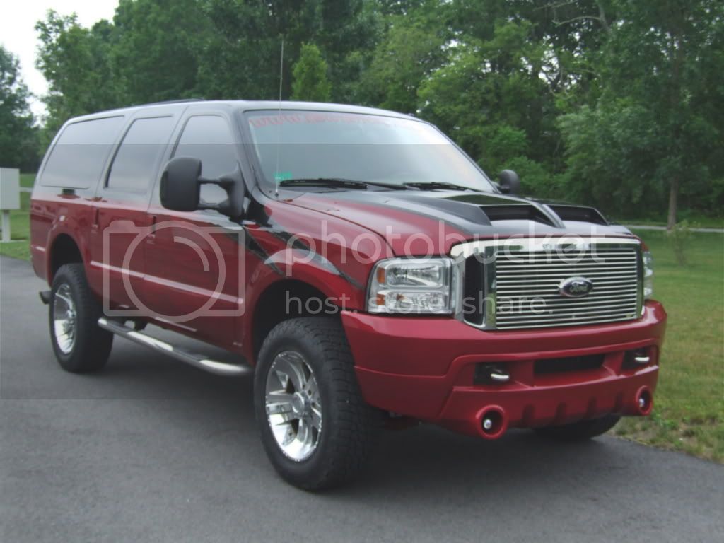

Back in my 6.0 Excursion days I planned to stud the motor all along, and the headgaskets let go literally as the parts were ordered and on the way so it ended up only being slightly inconvenient. After a turbo hiccup (my early build '04 had an '03 pedestal) Elite got me squared away quickly and I got my truck up and running.
THAT was a sweet truck (built by Funkmaster Flex for Orange County Choppers)...pretty sure it's wrecked on it's way to being wrecked now...
1 sharp excursion!!!
