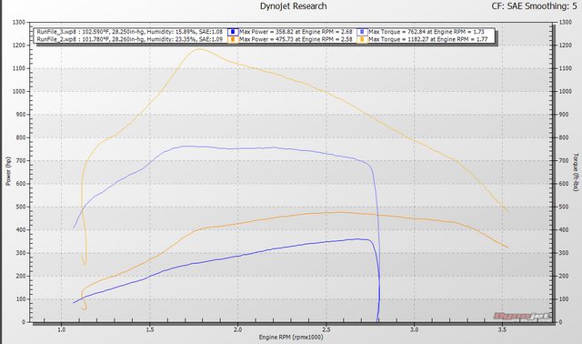

Here is our 100% stock baseline VS "high flow exhaust" and TSD SPD tune
100% stock
358hp
762tq
TSD SPD tune
475hp
1182tq
The TQ on these trucks is INCREDIBLE!!! 1182 ft/lbs of Tq at 1800rpms is A LOT OF FUN! The power just comes on so strong down low.

that lovely torque that comes on so soon is the reason rods exit stage left when much over 700 is made. hopefully when you are developing your turbos you have an excellent tuner with 6.7 experience so you dont destroy your motor prematurely.

What can you attribute the low end torque to on 6.7 compared to other platforms ? Head flow ?

Thanks for the advice. We have fear of rods blowing out the bottom end... but I will be working with the best tuners.
I know everyone references HP #s when it comes to rods even though most readily admit it is the low end torque that causes it... SO is there a "tq number" that anyone should be worried about?

I would venture to say that Head flow, cam profile, larger bore, common rail injection, tiny turbo, and the exhaust manifolds in the valley all attribute to the amazing tq on the 6.7
