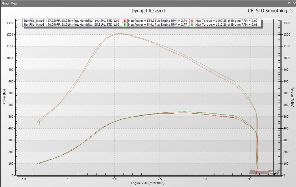

Well... it will be tough but doable. I am at 540hp right now since I added a no limit intake (after the dyno above, will post results in a few minutes). So 525-550hp should be doable on stock 2011 fueling IMO

Here are the results from the No limit intake we swapped on. Fit and finish were great! Thanks Mike! I bet the gains would have been much bigger if we had more fuel. Truck seriously runs super clean (almost like a stock truck), except in the upper rpms where you can see the gains from the No Limit Intake.
Peak HP gain was 10hp but you can see that the bigger gains came on the top end above 3000rpms. On the top end it gained about 15-20hp

im pretty sure that track times prove that 2011-2014s are only good to a little over 450ish hp with stock fuel and turbo. then with a 15 pump they are near 480ish due to being turbo limited.. but that info might be a couple years old from around the time i started messing with mine. last track times i have put it at 450 hp. might be stronger now with the new tunes but it drops rail so i cant hold it for very long to verify.
