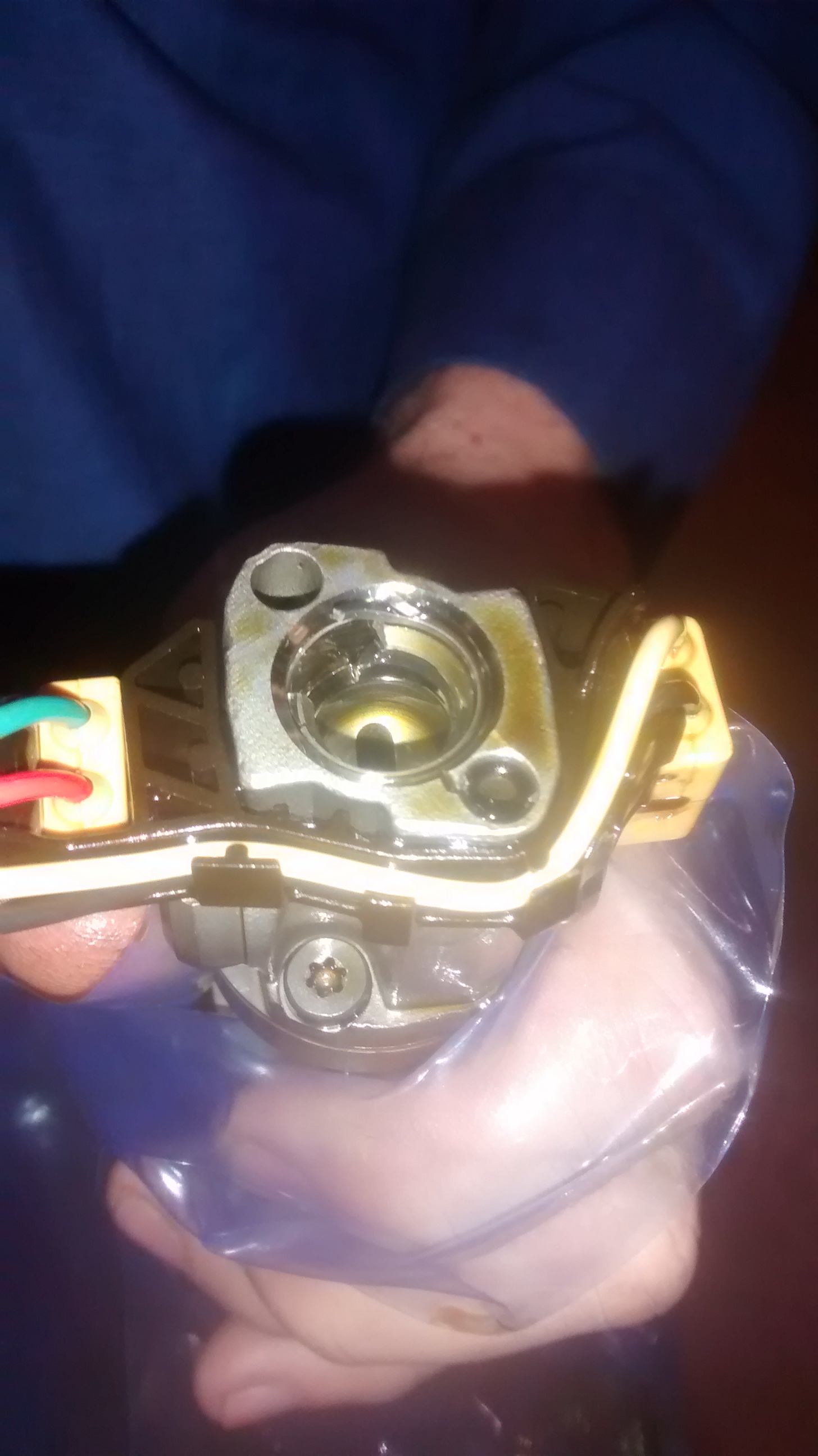

SledDogg
Jan 24, 2012
93
Ann Arbor
This is blowing an injector. Broke backing ring. Dead on hwy.
