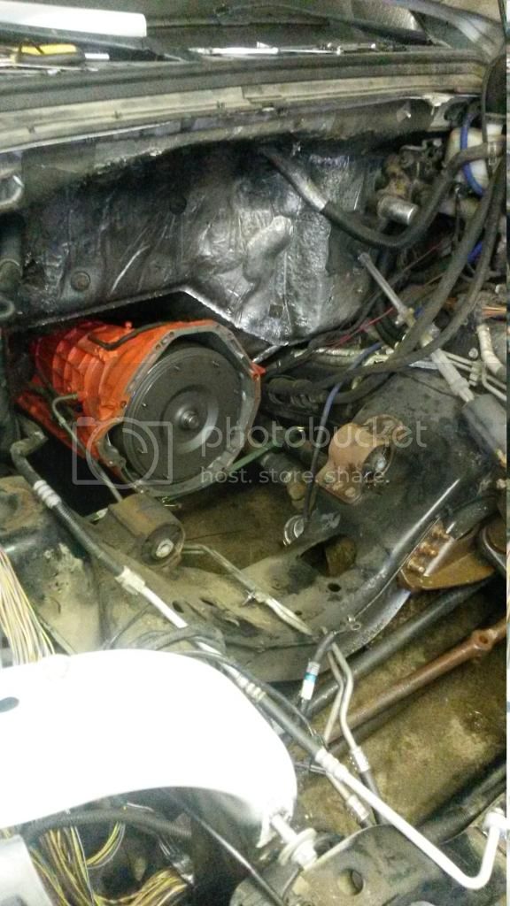

It's not that hard cab on. Once you get the core support off all the coolers just fall out and then bam total access to the front of the engine. Same with the battery trays when they are out you have total access to the sides of the motor.
