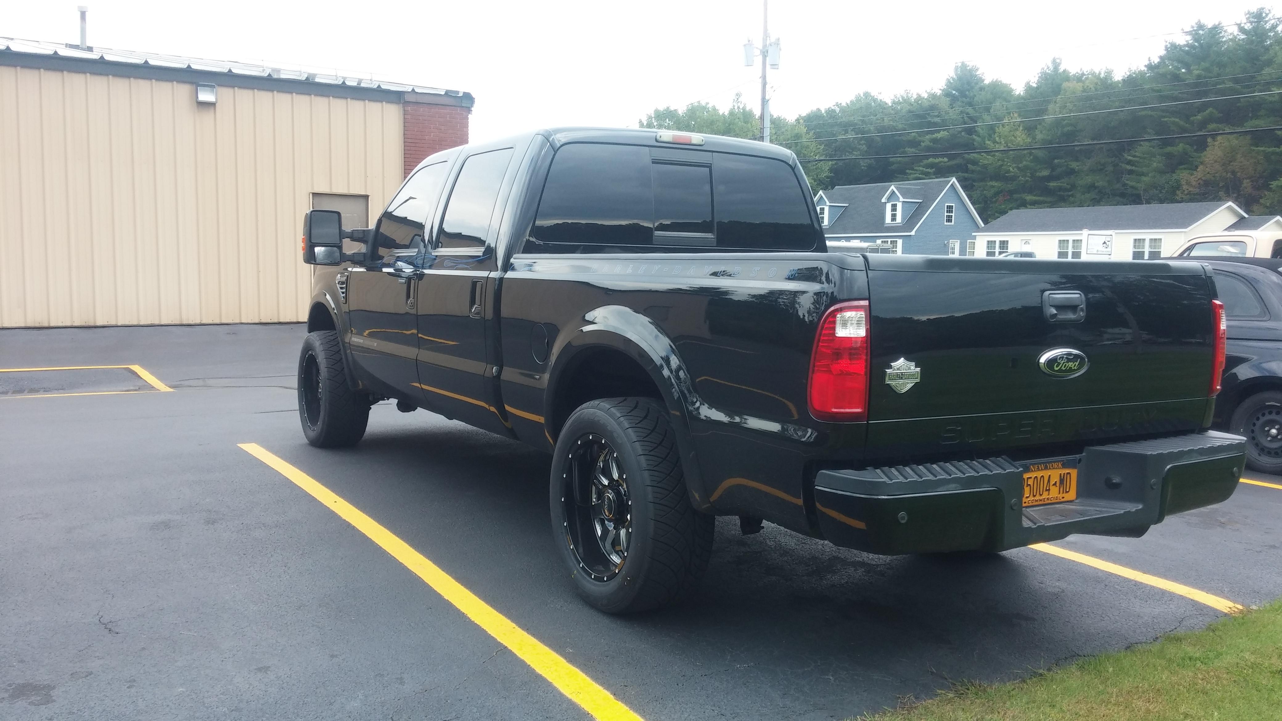

Lighter spring in the front and remove the rear block. That's basically it. Search the 6.4 aftermarket section and there are threads with part numbers. I'm running 4800lb springs in the front and no block in the rear. Have had the set up on for almost 2 weeks and love the look. Tons of people have done it.

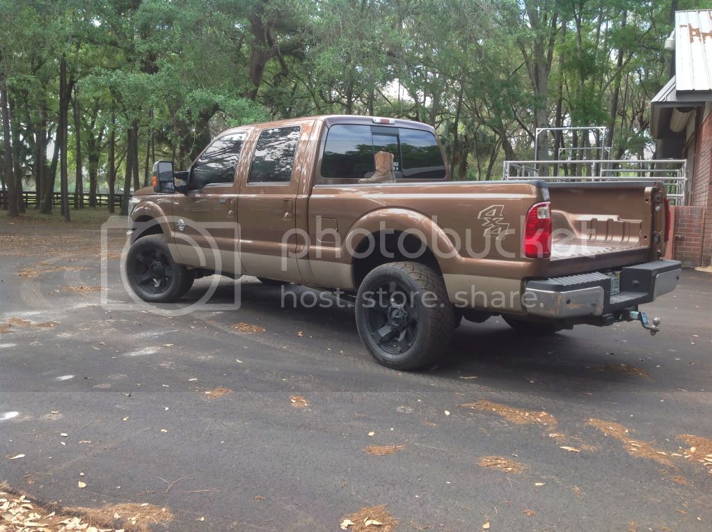

Here was mine with f250 2" blocks and uhhh springs... I'm guessing 52/5400 lbs... Florida truck so none of that plow crap...
I kind of miss the look and ride at that height.
Definitely more fun to drive on the 420's.
I know it's an '12 but they're too similar in wheel well size and clearance not to post.

Sorry guys didn't get on much yesterday. My wheels are 20x10 bmf reprs. Tires are 305/50 nitto 420s. I have 4800lb springs with no block. Looks amazing in person. Also RSK I have 1/2-3/4 inch between my bump stop and frame. Truck doesn't bottom out from what I have felt and I live in an area where salty roads and ice heaves cause havoc. I bought my springs from an eBay link that was on an old thread here on psa. Think I paid 90 or 95 for them
