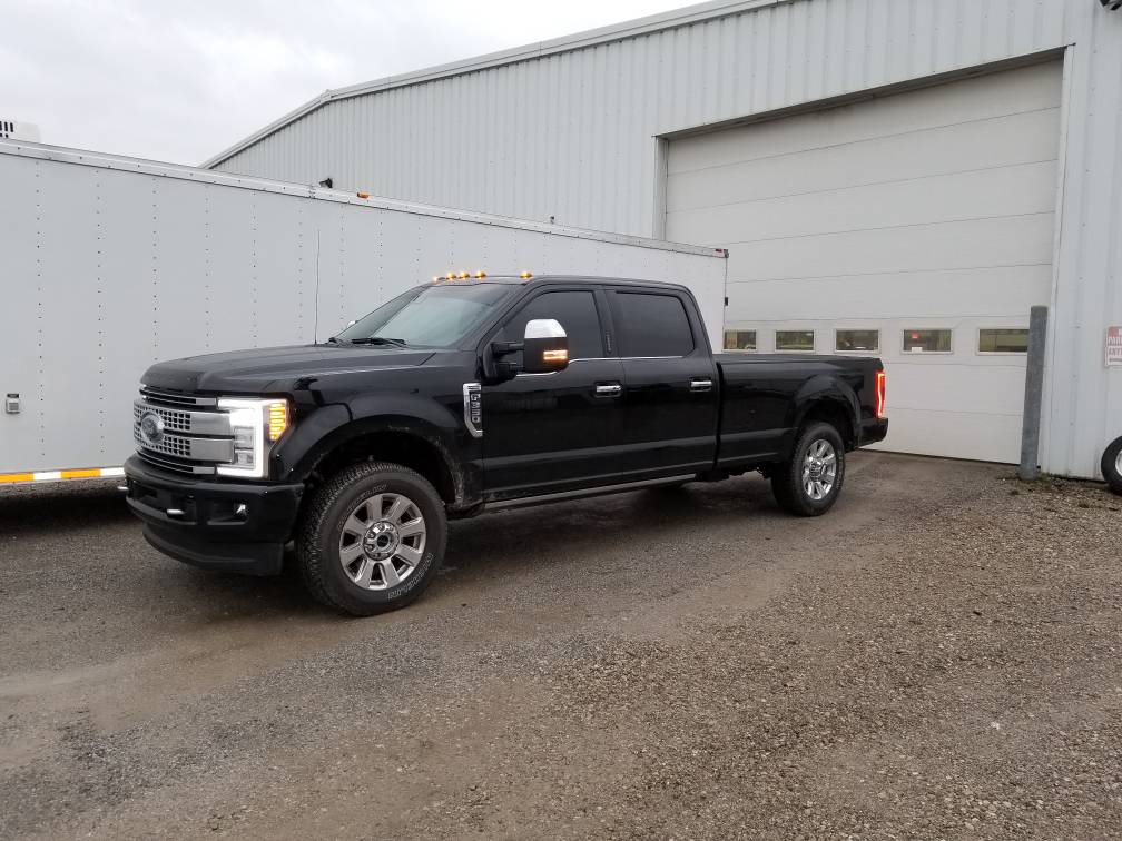

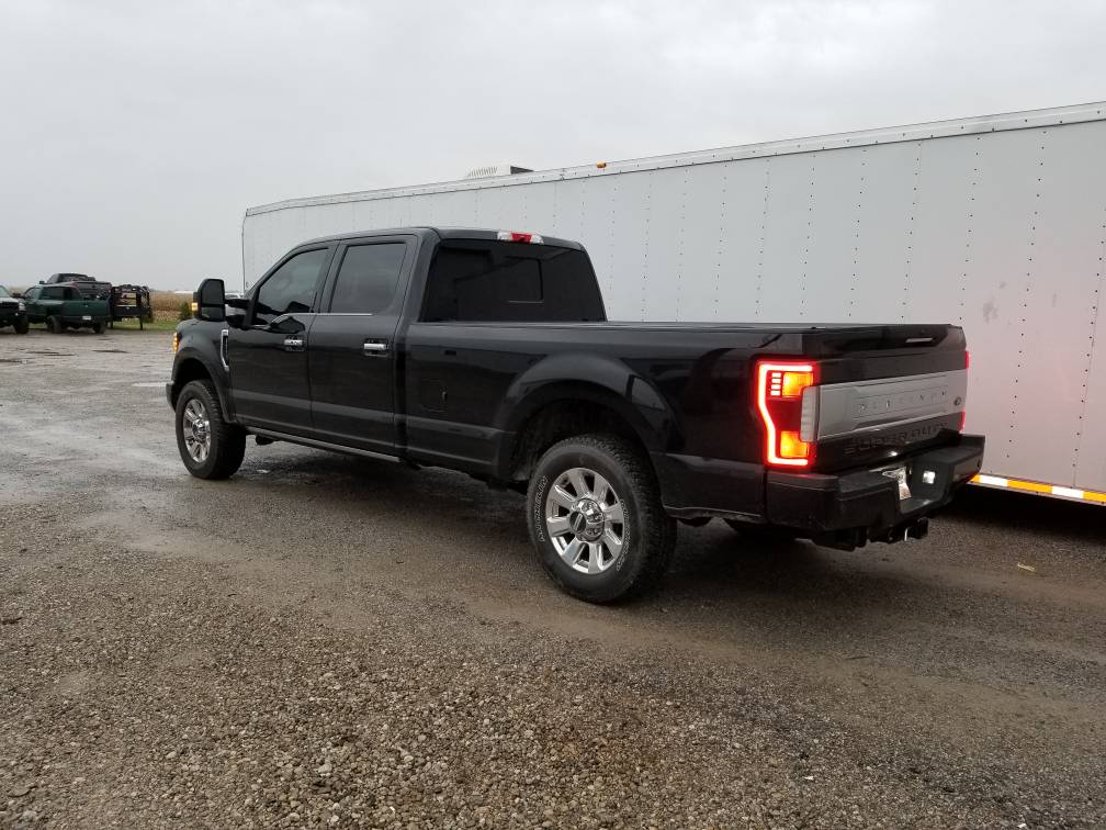

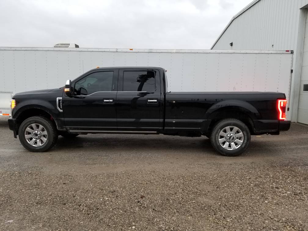

So I pulled the rear block on my 17' F350 and it now sits DEAD level. 1/8" or less difference from front to rear.
5600# Coils are what's in front from the factory. Looking at going down to 5200# or 4800# lb coils.
I really only need about an inch of drop in the front.
Jomax is the only person I know on here that has done this as well but his is a 250 so there are some minor differences.
Anyone know how much drop occurs with the difference springs on the newer trucks?
I wanna do 5200# and hope it's enough but then I'm afraid it won't hardly change since that's what comes factory on the newer F250s (from what I'm seeing)
I'm wondering if 4800# will be too much drop.
Only want to do this once so I can get the shocks ordered for the truck once the front is dropped.
