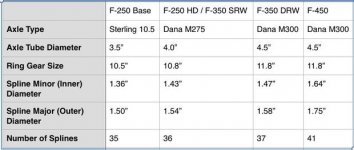

All 350 single wheel trucks with the power stroke have the bigger m275 rear axle, with 4 inch tubes as well as some 250s with the tow package. The other 250s will have the sterling axle.
Also the 350 dually and the 450 comes with the m300 Dana axle and those have 4.5 axle tubes, the 350 duallys axle shaft is just a bit smaller in diameter and comes in 37 spline where the 450 is a 41 spline.

Axle info
Here is some info for everyone.

Garett742
Dec 6, 2013
14
I forgot. The 17+ trucks have two different rear ends. Standard rear ends are the old sterling 10.25 axles and the the trucks with the heavier tow package options have M275 axles which are bigger in retrospect than the sterling.
So really you'd have to check which rear end the truck has first.
Sweet looks like we got that figured out! Just wondering what were the wheel and tire specs you had on your 17? Everything I like is -44 since every company uses the same place for wheel blanks for 22x12s it seems like. Not trying to rub, but also want to be able to tow and not sure I want to run a tire with small side walls
Thank you for the info!
