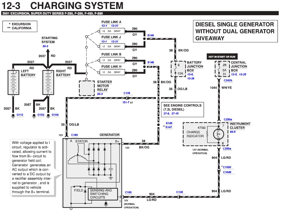

After doing some more searching, I have some more possibly "key" information.
Took the belt off, problem went away!
Checked all pulleys, all were great, reinstalled belt.
Restarted, problem there.
Removed fan clutch, problem still there.
Removed the alternator wires while running. BAM, oscillation went away.
Alternator producing 14.1v @ low end of the oscillation, 14.4v @ high end of the oscillation.
Swapped alternators same problem.
I will try and look @ it more tomorrow. But basically as long as the alternator power wire is unplugged the truck idles without issue. I am going to figure out what the readings should be @ the plug... I'm figuring that whatever controls the alternator plug is bad, causing it to load/unload the alternator, giving us the oscillation. I will hopefully know more tomorrow.

Just throwing this out there. I had a truck where the volt gauge went bad and the alternator wouldn't charge. Different cluster and it started charging again. Maybe something is wacky with the gauge?

No, the truck is still at the shop.
The alternator is charging just fine. Everything checks out electronically.
Unplugging the ICP bumps the idle/icp/ipr up which masked the problem. This isn't an ICP related problem.
If I unplug the main power wire to the alternator then the truck doesn't have an issue. If I unplug the orange wire on the 2 pin plug then it doesn't have an issue. In both cases, the truck isn't charging, obviously. If I give 12v power to both alternator plug pins, it still has the problem. This isolates the under dash fuse panel or instrument cluster as being a potential problem.
The truck has been backed outside. I guess I will try and get back to it asap, but for now I don't really have any direction to head.

Did you check alternator AC ripple? I see it all the time on older GM cars. The diodes start to go bad and cause rpm surge for some reason.
