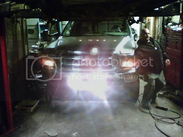

Here ya go! If you want I can still pop my headlight switch off the dash and snap a pic real quick of the wires for you so you can see what it looks like... But this is what I used to do mine and havent had any problems (im using cheap HID's in my fogs too). And the pic he has is the way I usually drive at night since my truck is lifted, my headlights will tend to be right in peoples mirrors
Well it was an idea I had about a year ago that I never followed through on. So last night I was dicking around at the shop and I was like this is a no-brainer.
On the pre-2003 strokes you can't have just the fogs and marker lights on. But now you can!
Splice into the yellow wire :doh: behind the switch and send that over to the accessory position of a toggle switch, splice into the dark brown wire :doh: and send it over to the power position of the toggle switch. If you want the switch to light up when it's got power or not then you have to ground it.
The best part about this is that you can not have your fogs on without at least the markers on so you can't accidentally leave them on w/o hearing the factory warning beeps. These are the configurations you are now able to do...
Marker lights only, marker lights w/ fogs, head lights only, headlights with fogs, high beams only, high beams with fogs.
So in essence you now have the 2003+ switch with the addition of the "bright box" mod.
I also installed some silverstar 9005 bulbs in the fog lights and they're bright as hell.
Here's a pic :D
