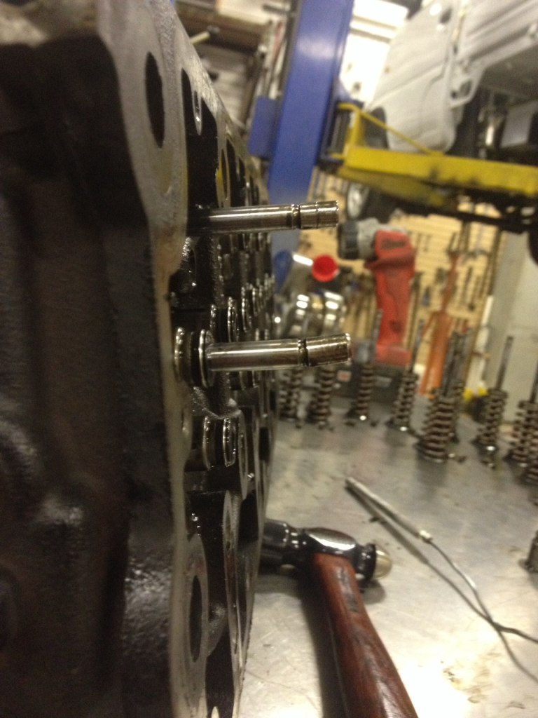

We we're taking the valves out of the heads yesterday and found a problem.
Had to cut 5 of them out of the head.

I think there still ok, they are getting sent off to get checked, decked if needed, and afm ported. So we'll find out for sure then.

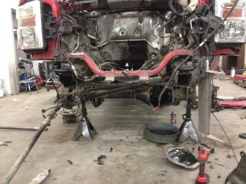

Worked on the axles today. Have the Dana 60 apart and ready for the new gears
Have the Dana 80 started just have to move the spring mounts and move the drivers side shock mount.
I have to wait to finish the back axle when the trutrac comes in. since I have the one for a 3:73 and down, so it's not working to well with the 4:30 gears. Should have it about Tuesday or Wednesday. Going to try and sell the old one to recoup some lose.
It's got about 3k on it. Fit a Dana 80 3:73 and smaller, sells for $300.
Sent from my iPhone using Tapatalk 2

What are you replacing? The gears or the whole diff?

Cool. I just bought an 80 to put in mine once I get the time and whatnot. My problem is I want to keep the factory 08 brakes and width. So I'm not sure as to what all I need to do to it.

It's a cab and chassis 80 so it's the right width I just had to move the spring mounts out an 1.5 inches and turn the shock mount around towards the back for the short bed.

Well sh!t. I hope the one I bought is a c&c too! Well 1.5 inches isn't too bad at all. I'm excited to see the end result of this build. It ought to be an animal! If I didn't fear the II pumps so much I would probably be copying you!
