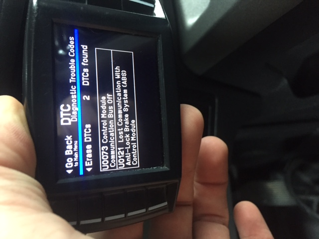

This morning I got in my truck and the hill decent and traction control lights are flashing on my display. As soon as I pull the MM off the HDMI cord it stops. Truck was fine last night as this just happened this morning. I'm thinking it's the HDMI cord ( have it running across where I removed one of the cig. lighter near the Aux switch panel) but could the tuner be bad? I dropped the tuner from about 2 ft up a few days ago for what it's worth. Also got the SES code. Any insight on this is much appreciated.
