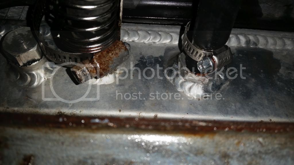

So now that I'm upgrading my Trans lines.. what did evey one use for the bottom driver trans line bungodly fitting. Looks like 3/8np. Bought a 3/8npt to 3/8 hose barb and it is slightly and I mean SLIGHTLY larger then the bung. WTF?

Welded bungs on all 3
