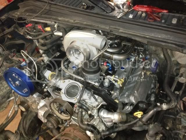

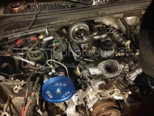

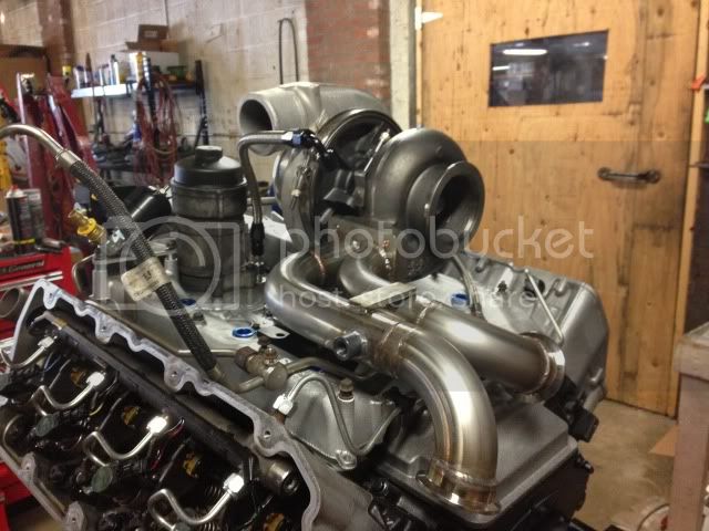

I cut my factory feed hose as low as possible but enough to get the compression fitting to work. And as far as the unused drain, I installed a freeze plug in the opening. First pic you can see the freeze plug, second pic you can kind of see the drain installed, third pic you can see where the supply is cut. Hope it helps.

awesome, that helps a lot! anychance you remember what size freeze plug you used? and was your drain kind of hard to get all lined up and all? I know there is no pressure on it, but stilll dont want to have it leazking or anything
My drain wasn't difficult. I installed the drain on the turbo center cartridge first and then installed that into the turbine housing. All I had to do at that point was screw it onto the drain adaptor. And as far as the freeze plug I want to say it was 13/16" but I may be wrong. I don't remember exactly. Put a dial caliper in it and measure the inside. The one I got was a perfect fit.
