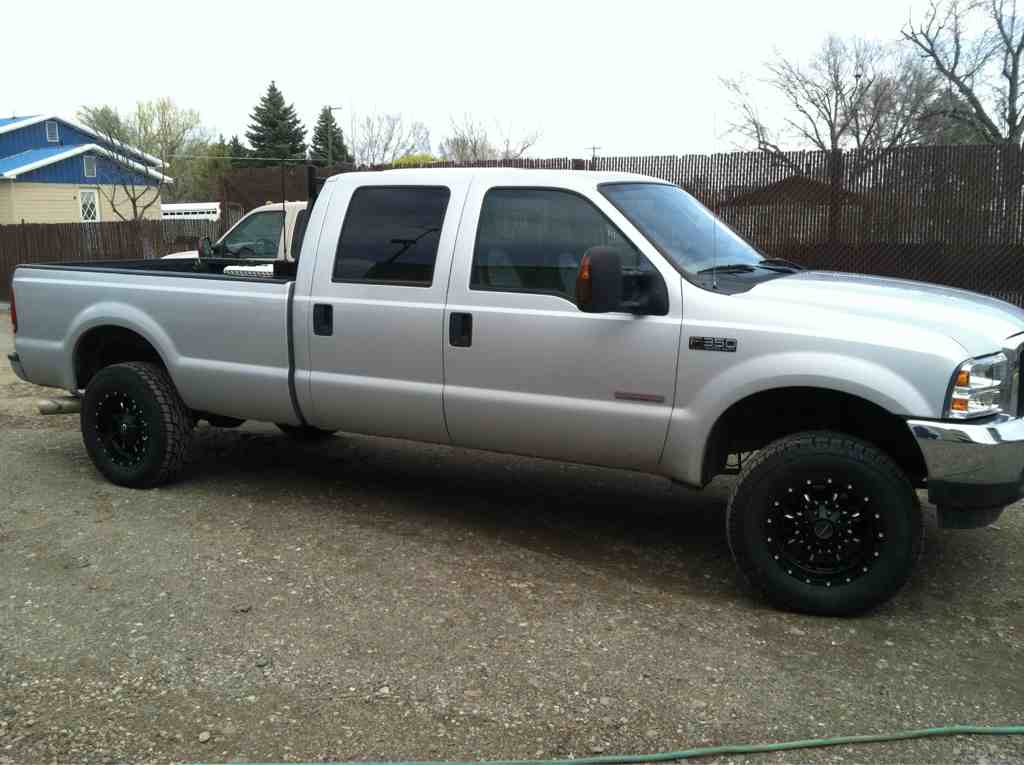

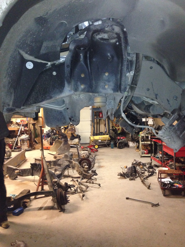

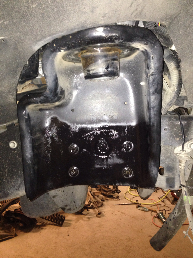

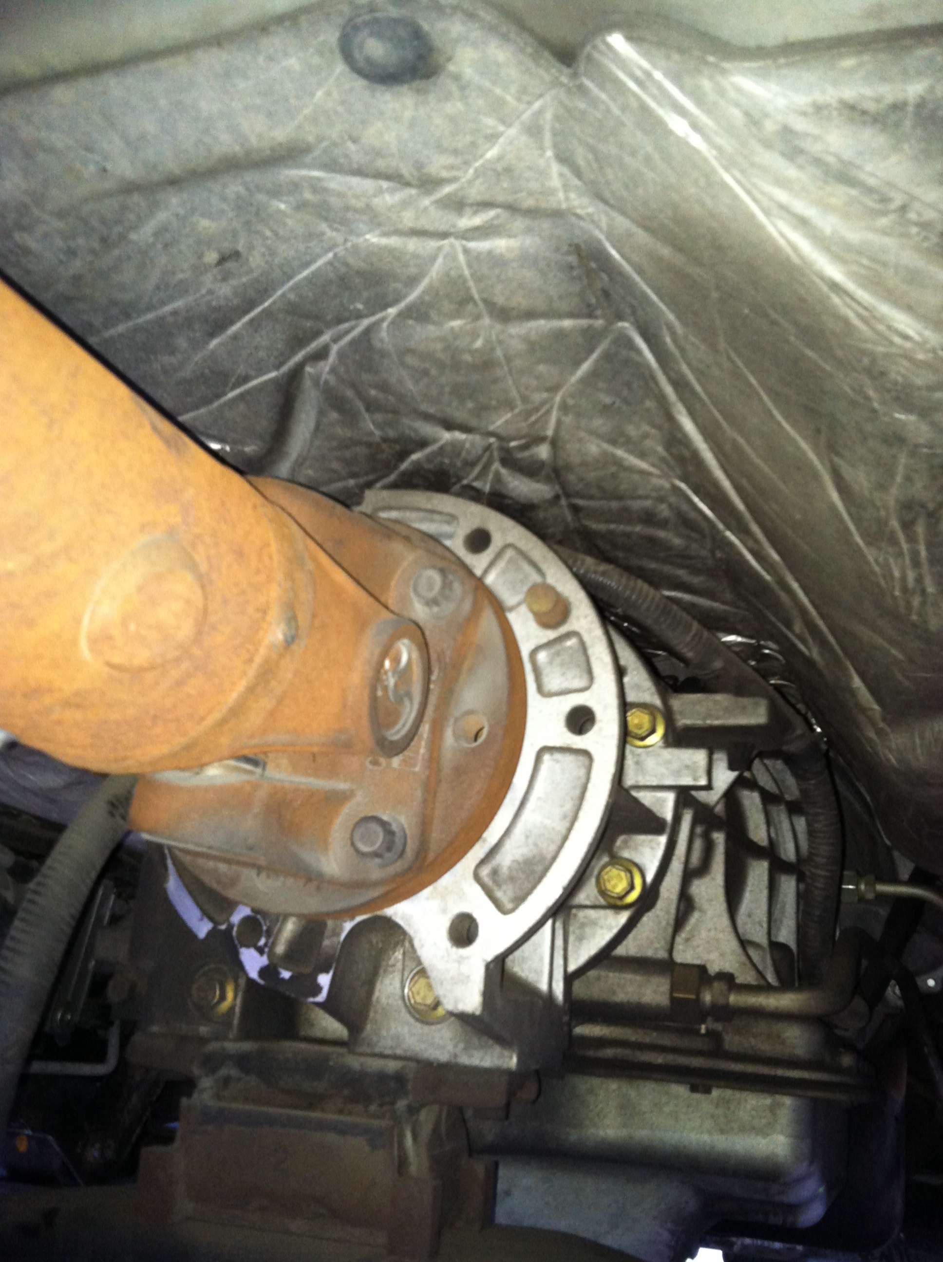

The frames are the same, stripped the 2wd spring buckets and all bolt on brackets. Installed 4wd spring buckets. Bolted in the front end with C code coils. The tranny is the same for 2wd and 4wd. Just unbolt the flange and slide on the t-case. There is a block off plate in all the cab floors for the linkage.
I have only finished the suspension so far but I converted a 04 and they are pretty much the same.
Before

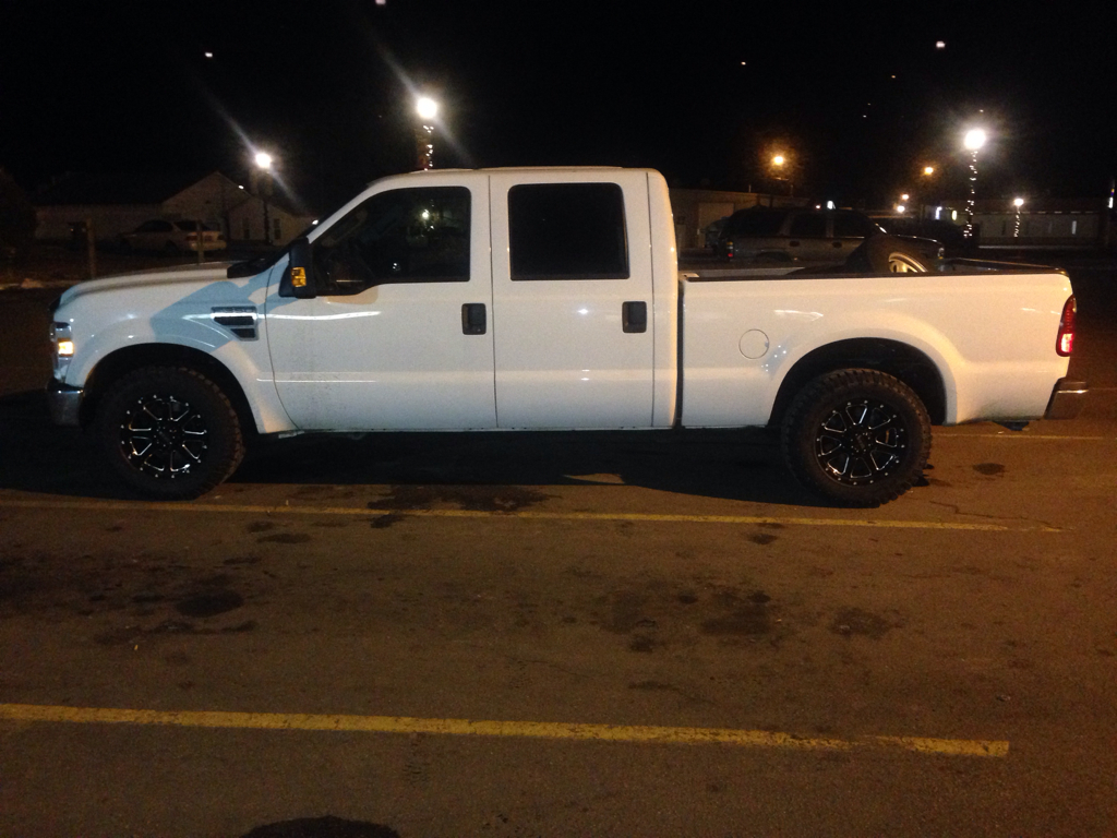

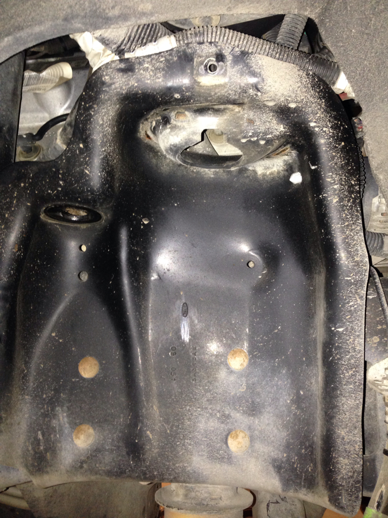

Before
