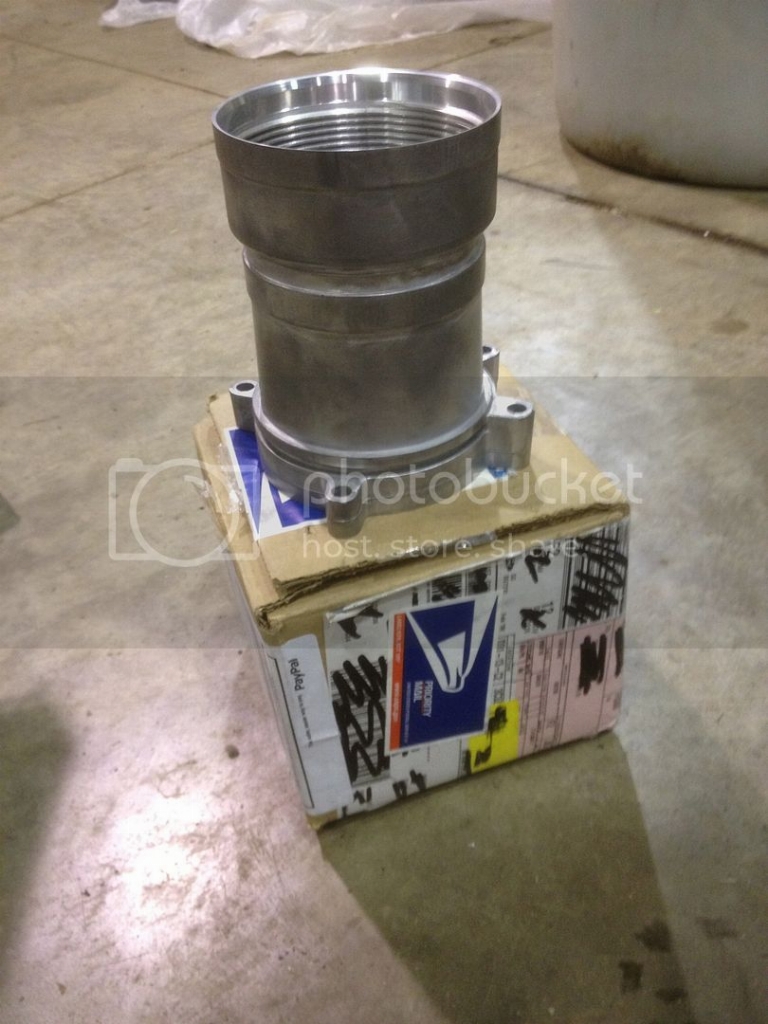

i believe mpd made them at one point. rcd also sells a full relocation kit.

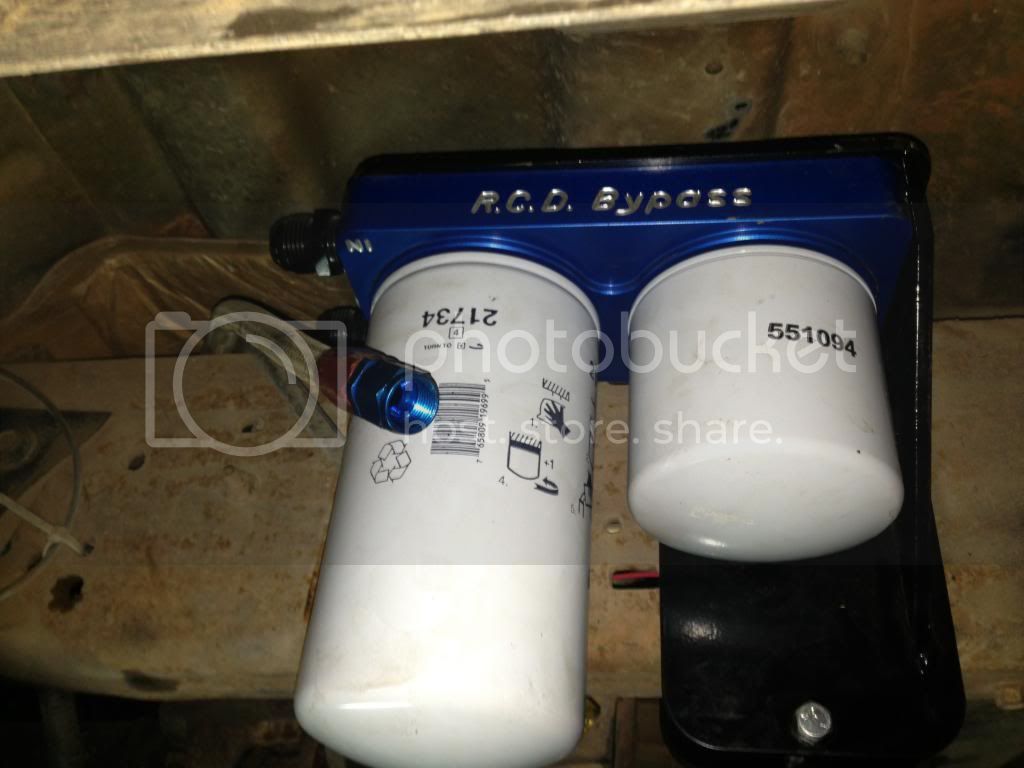

Is that kit just for the oil filter or for both the oil and fuel filters?
RCD's kit is just oil. The fuel bowl is attached to the oil bowl. when you delete oil the fuel is gone to. you will need to run your fuel feed straight to your "t" or "y" for your heads

Just buying a 6.4 housing doesn't mean it magically transforms into a fuel bowl delete tyler LOL you need to make fuel system modifications, its very easy though.

If I'm deleting the fuel bowl and moving the oil filter it will be when I do an external oil cooler setup.... RCD kit is sweet but I don't "need" it so I'd rather wait and do an external cooler setup instead

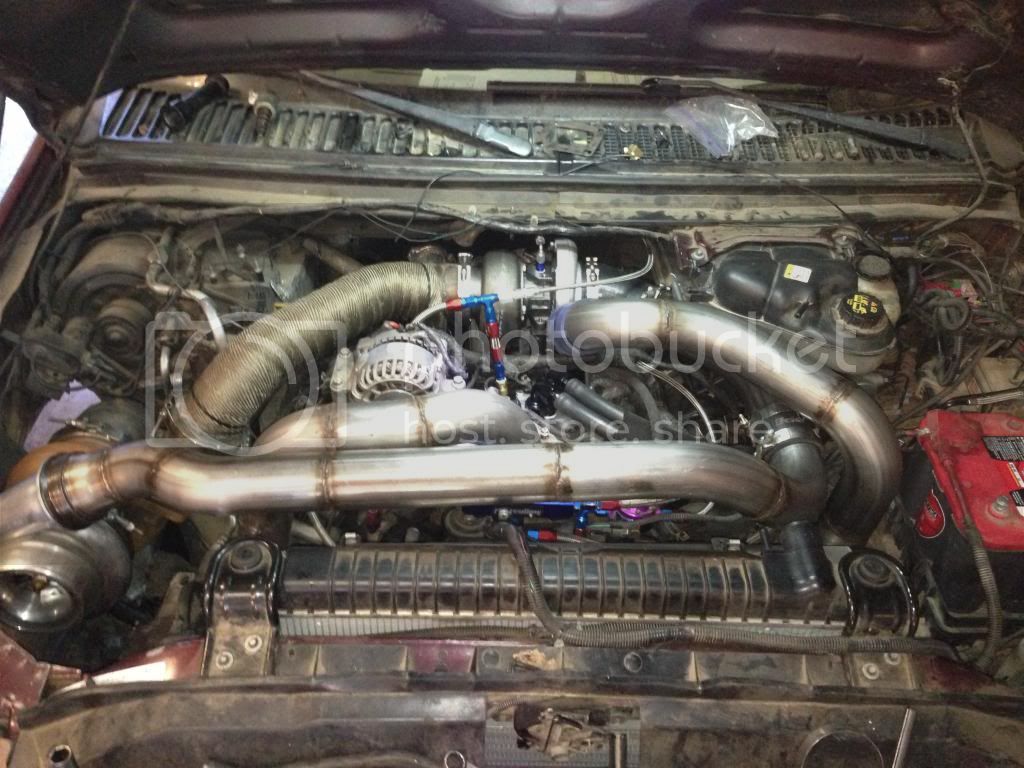

Hoodstack is off the truck for the winter. Have a few little power adders hopefully going on before our dyno day next month. Hopefully we see some good numbers finally!!
