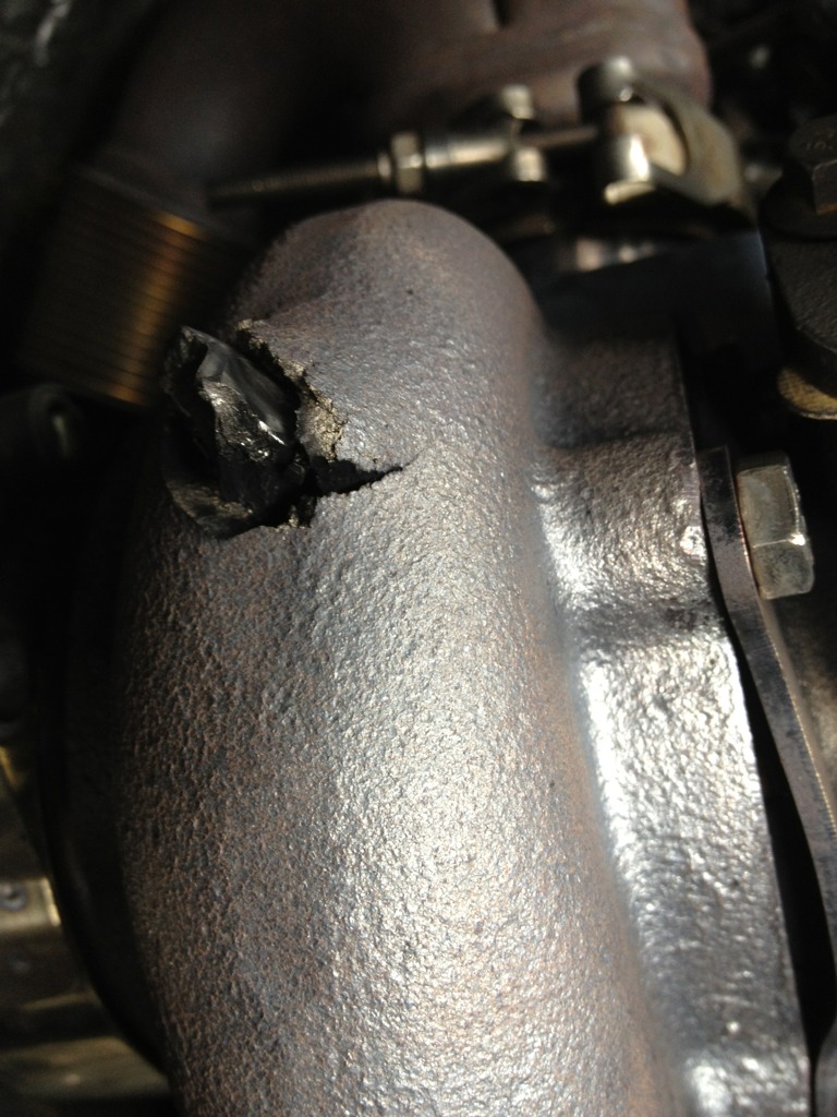

Sitting on the side of I-10E rught now heading to Louisiana for the weekend. Going up a little hill, laid into it a little bit with 20lbs of boost and heard a boom. 'intercooler boot, no big deal' wrong LOL. Matt@CED is working on the issue now

I'm thinking wheel(s) out of balance right now. During testing, I had 46lbs of boost and 54psi back pressure. So I don't think it's a BP issue.

People run higher bp than that. It def looks like a balancing issue. Either that or the wheel wasnt on right/tight.

Exit 789 Thompson road. Tow truck will be here at 2:15. Towing it to PSM. I'm supposed to be in Mississippi tonight. My woman is going to be PISSED lol
That'll make a nice souvenir :doh:
