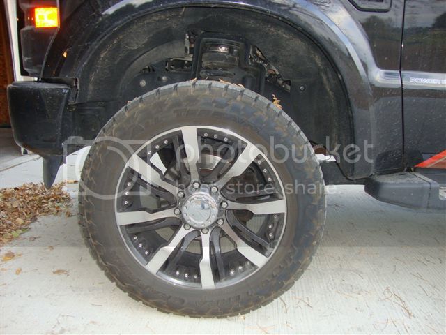

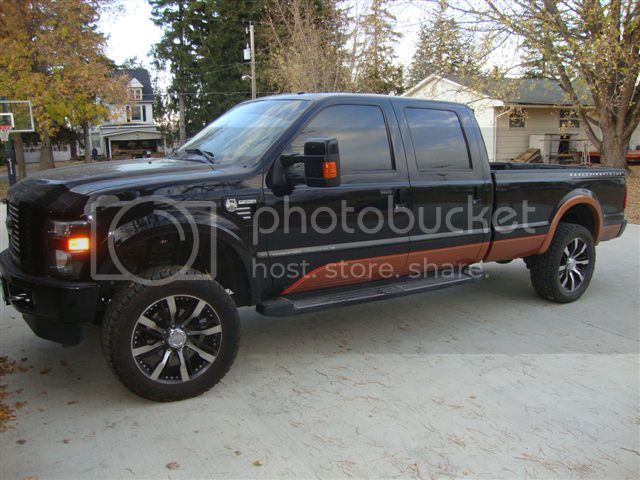

Here's the pictures of Dan's truck with the new 22's. I actually seriously like how they look on it, almost better than Harley wheels.
I do like those better than the Harley wheels. I also switched mine, due to the Harleys only being 8 inches wide... I needed some more rim and tire under there...
Looks sharp guys!
Is that just a level kit? or a lift?

Jared is correct. It is a 2.5 Readylift leveling kit. Put the F350 taller spacer blocks in the rear as the front sat too high with the stock F250 spacers on it to level it out. Wheels are Cruiser Switchblades 22x9.5 +30 offset. Tires are Nitto Terra Grapplers LT 325/50/22E 34.84 height. Got my ladder bars yesterday also so everything will be done at once.
