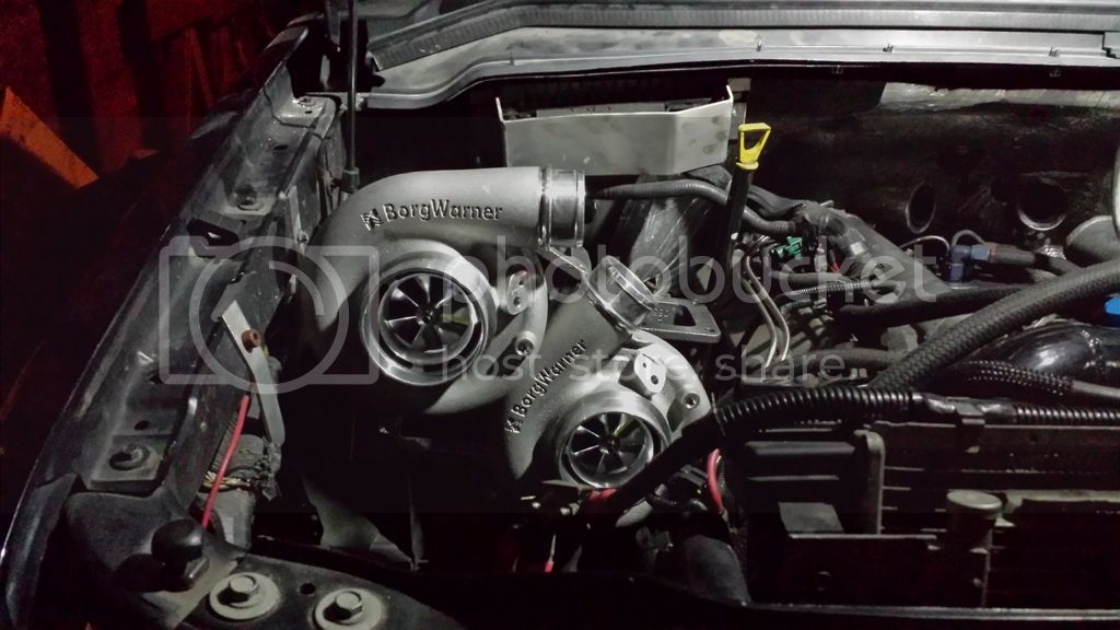

Small update: it made a hair over 900 on a street tune a few weeks back. Something like 115 lbs of boost. It needs some more dialing in. Hoping on a bigger tune with things dialed in a bit more the power will go up quite a bit. But it sounds like it is all ready to be picked up now that it has a few hundred miles on it. Can't wait to get it back.

Two s369 atmos and a s467 high pressure is the new set up. Also will be switching the diesel dr dual fueler out for a Beech kit.

Thanks Shane. I'm going to try to make the ac fit this time around. I pushed the atmos quite a ways back to accommodate the dual fueler so one of the down pipes is gonna be pretty close to the accumulator. This weekend I am hoping to redo the top turbo mount to get it a little closer to the lower atmo. If my parts show up, I'm also gonna try to get the down pipes fabbed. Waiting on a few bends and an inner fender liner from Sunrise. I need to look at the ac system a little more as well and figure out what I am missing and how many stock lines can be reused.
