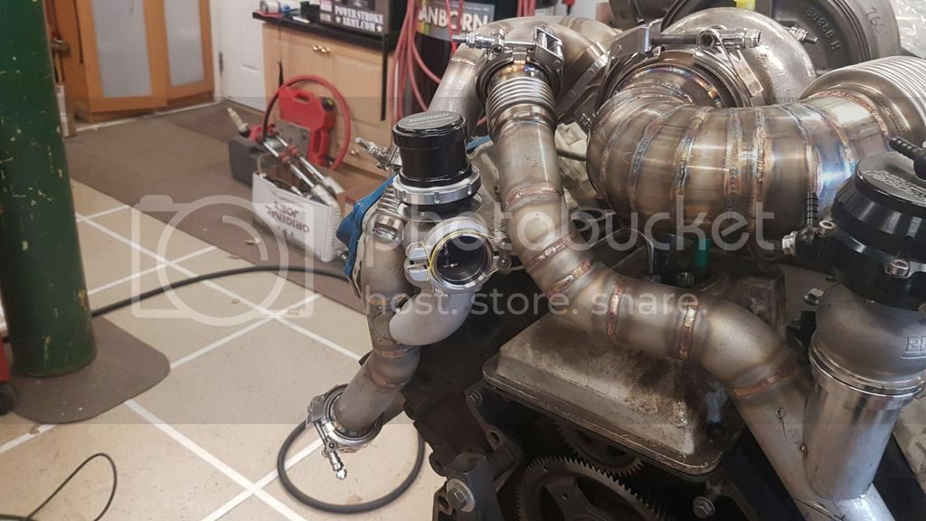

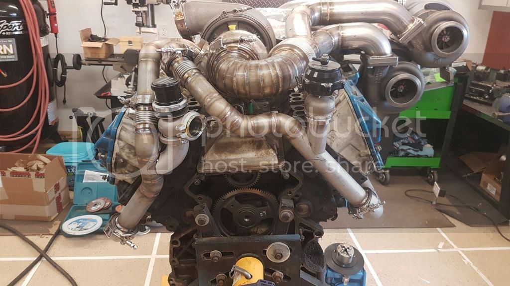

Slight change of plans on the wastegate setup. Going to use a wastegate off each up pipe. New gates just arrived so as soon as I'm off shift I'll get started on it. Matt will post pics though. Hopefully have a complete kit to send off very soon.

Shane is correct, we are doing away with the single jgs 50mm and going to dual 40mms. Can't wait to see the kit in person.

Shane's getting the new gate set up fabbed up.

The dual gate setup was actually my idea after talking to Shane. I've bugged Matt for over a year about buying his truck and after enough arm twisting he is letting me take it off his hands. Once he gets the kit in from Shane she will be heading south to Louisiana for me to tinker with her a little more.

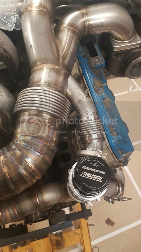

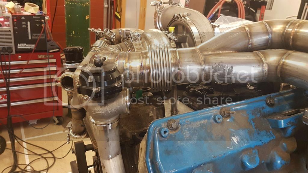

Shane and I decided to go with two Turbo Smart gates. One showed up so he used a precision to go ahead and mock up while waiting for the second one to show up.

So how exactly are you going to fill it with oil now that the pipe goes directly over that part of the pass valve cover?
