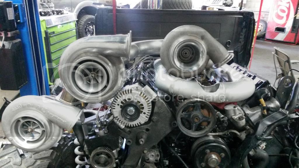

Thats pretty clever way to do the two atmos should be cool as hell when its done.
Just make craig put air filters on it lol

Build list
Triple s400's
Up pipes with JGS 50mm gate
MPD Exhaust manifolds
MPD Intake manifold
MPD 100% over nozzles
MPD Egr delete
O-ringed heads
RCD Push rods
RCD Valve springs
RCD Rods
IH Pistons
ARP Studs
4r100 conversion
Diesel Dr. Dual fueler
AirDog 165
MPD AirDog upgrade
ATI Dampner
Oil filter relocation
Spearco Intercooler (already installed)
I think that is about everything, but I probably forgot something.

Yeah, it makes the hot side piping way easier. Craig is an animal. I think he started fabbing stuff like Wednesday night. I already expressed my desire for air filters and Craig said they would be on there.

Those are just mock up turbos, by the way. Mine are billet wheeled and don't have race covers like these do, so fitment won't be quite as tight.

Is there something in the way that would inhibit them from have making the high pressure charger sit sideways, with the intake facing the drivers side? Just seems like the up pipes wouldnt have the bends they do and the intermediate pipe would be more direct. I know they have done compound set ups positioned like that, but your hp charger doesnt appear to be in the same location as a typical compound set up.? Definitely looking forward to see how having an s475 as a hp charger spools. Its definitely going to have some air!!

They were going to mount the HP sideways, but it wouldn't fit with the intake manifold. Craig actually had a set of up pipes half way made to do it that way.

Trust me craig had his work cutout with 3 400s in there... This was the best option, and its going to be wicked as hell when its done. Ill make sure this thread stays up to date.
