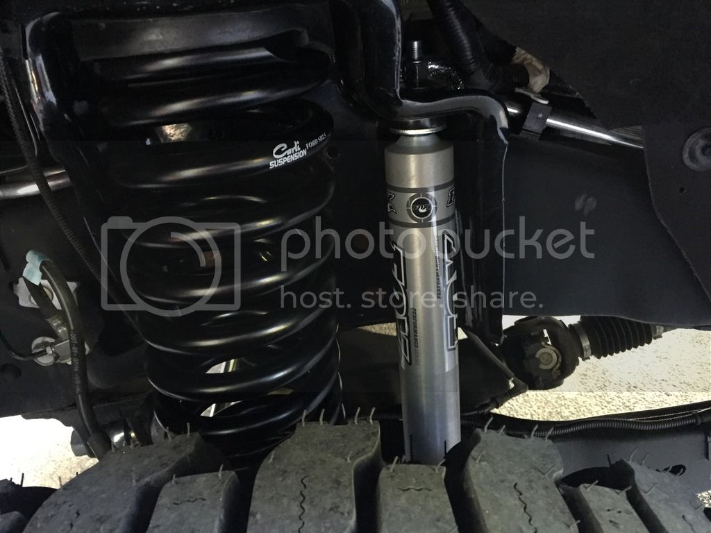

Front coil spring and fox 2.0's. Wanted to see how they did, once I get off road I'll really see if I can "live" with them or if I indeed need to go with Kings.
