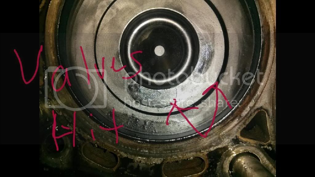

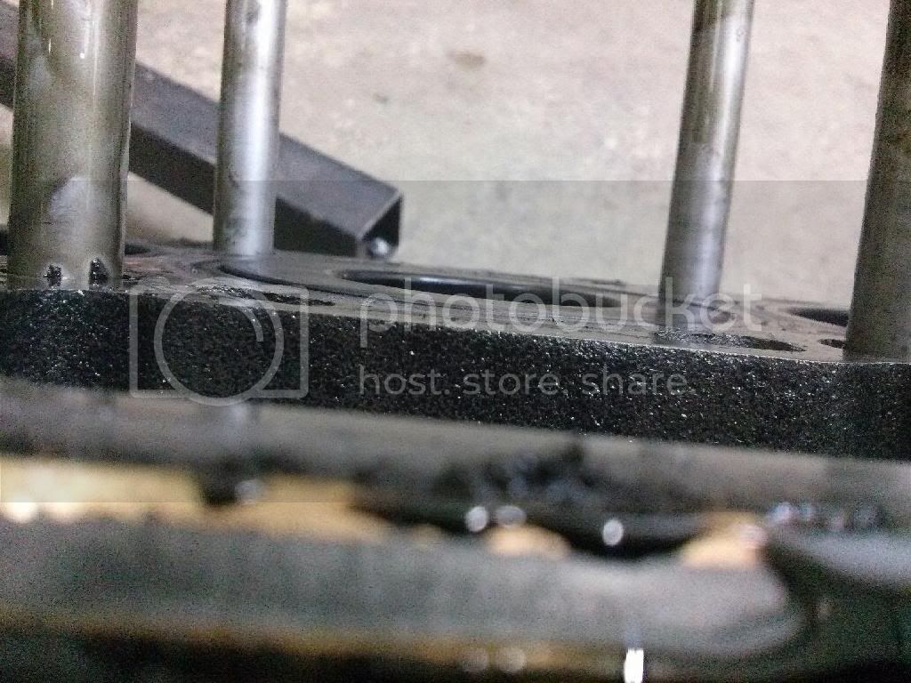

Well it looks like I was about due for a stronger bottom end. The valves had kissed the pistons and it looks to have a bent rod or 2
madman1234509
Nov 20, 2011
2,669
mayfield, ny
Are those from exhaust or intake valves? Did you have valve springs, or an operating waste gate when spraying?
Good thing you caught it in time. Would have been a speed bump in the build if you destroyed the block past the point of boring it out. Amazing these things keep on running with slightly bent rods, or I remember threads of people doing a HG job, and finding cracked pistons. Could have been just one more day of driving and it could have came apart.
I have springs and I have a gate. This happened a while ago I think. Buddy did a burnout while he manually shifted from first to third. It was off the rev limiter. Only time its hit the limiter. It would have sucked find out the block was bad though. Fingers crossed that's its all good as he hasn't completely dissasembled it
