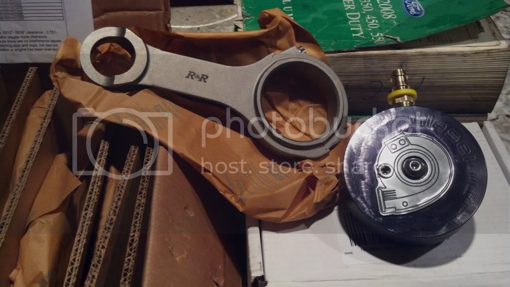

Gapless rings will be on the way as soon as I get a day off Ryan. Stoked to see your build.
