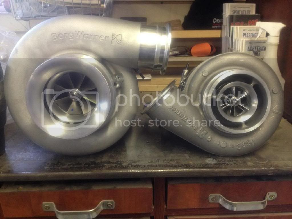

I would go no lower than that one. In fact I may have nates re-stalled as it's a little too laggy with the 475. Thinking s480 and 2700 stall will be stupid fun in his truck. Now if I could just get him to let me put spray on it......
Ryan don't make a mistake and go too tight. You will only regret it. Looser = easier spool.
We can't get nates truck to stall past 2k with the brakes on till boost builds. He needs to be looser. Just for reference.

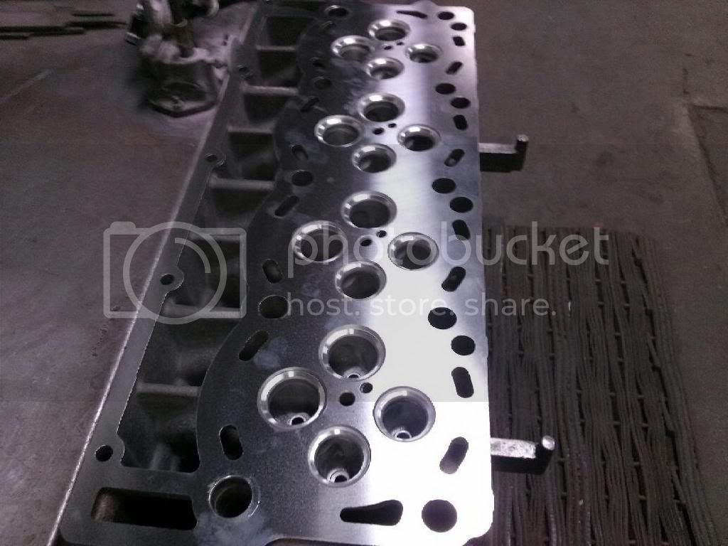

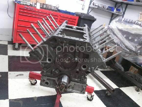

Heads are pretty much done and ported.

195? Typo? Can you shed some light on why not so tight. I was thinking 250 on all of them except the 4 next to the lifter valley and do those 225.
