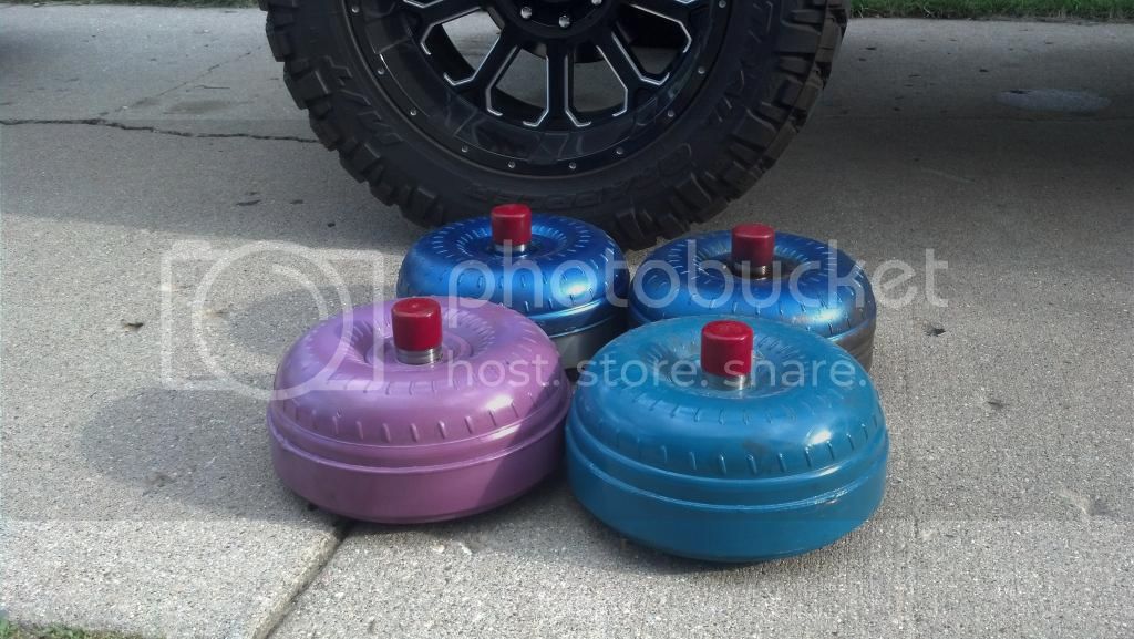

Not much to add. Have to send a handful of convertors back. 3 DPCs including the one in the truck and 2 precisions. Trans is now out and at the builder to make sure everything is all set.
Who is building you trans? And who did the work on you engine I'm in Michigan and I'm wondering if there's any good shops around
blk350on20s
Jul 5, 2011
2,720
I have Cory at A&J trans doing my trans work. I did the motor and turbo setup myself and c tech did all the machining to the block and heads.
