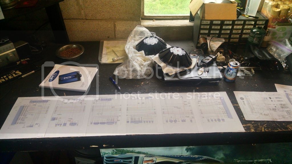

Might be calling you tomorrow Nathannial haha. Seems somewhat straight forward now that I have schematics but with sand drags next weekend I'm trying to plan ahead so everything goes quick and smooth.

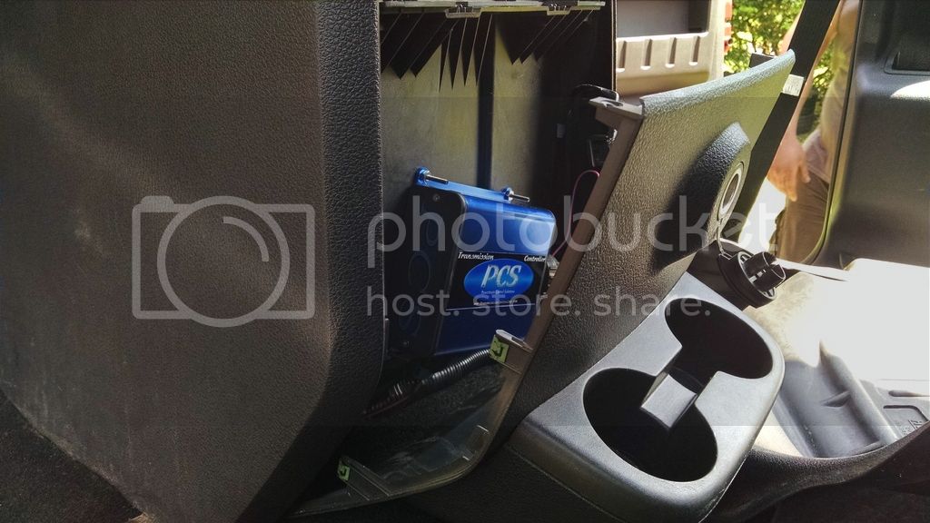

Trans is in. Most of it wired. Linkage and some wiring is left. Then tuning time.
The wiring fun....
