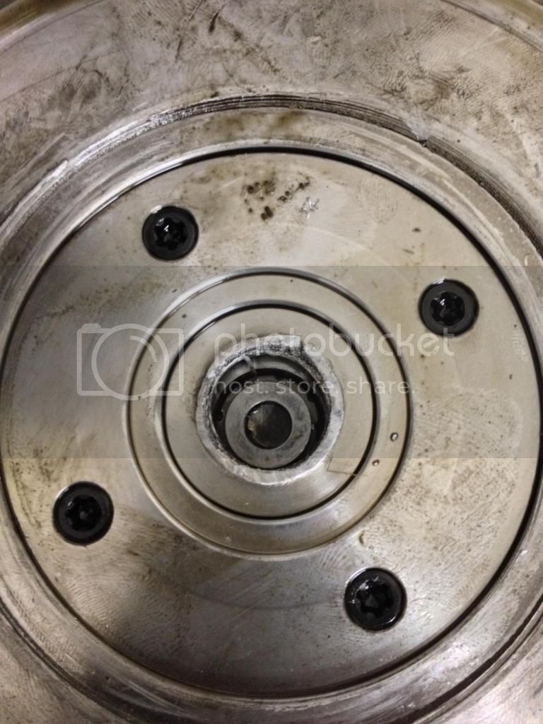

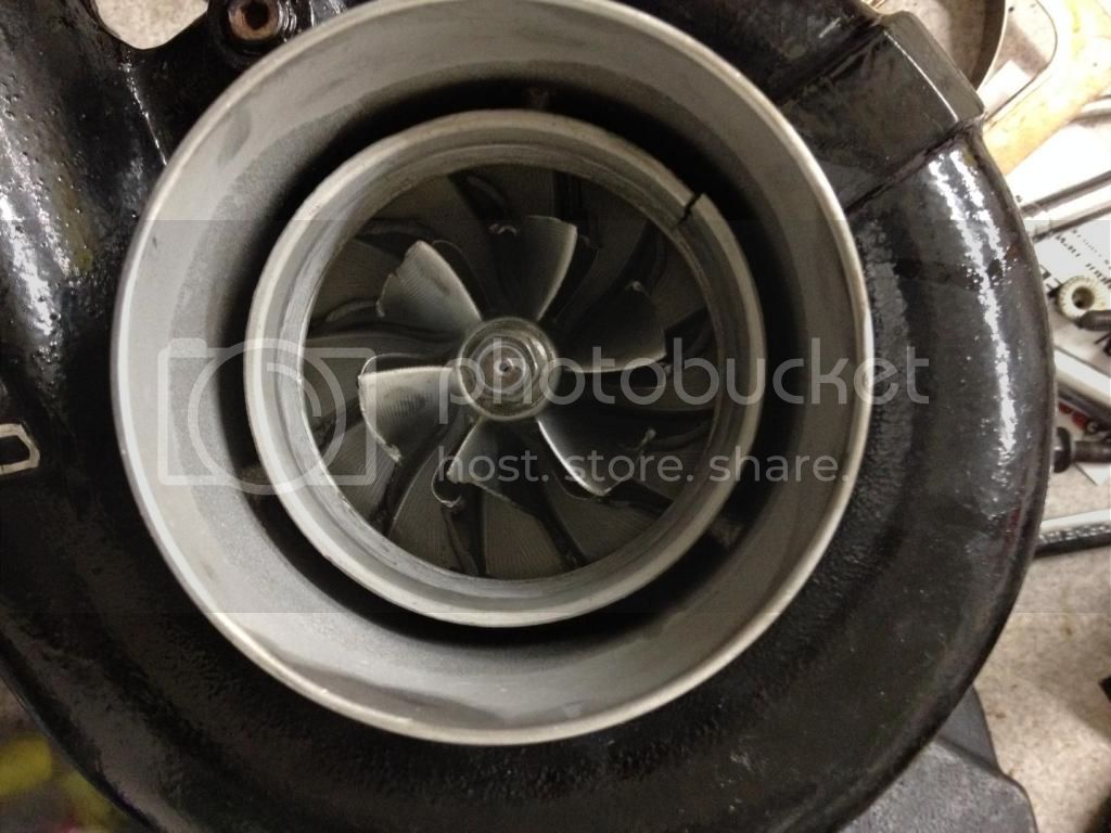

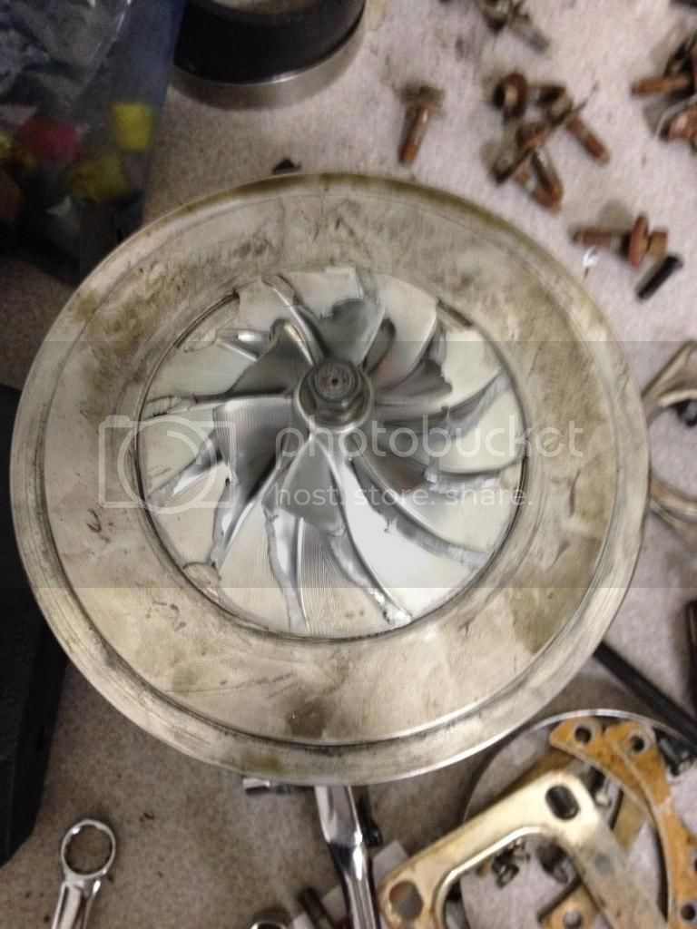

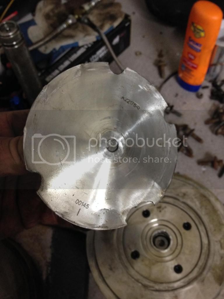

all depends on how hard it was driven, and was there an oiling issue. you definitely don't wanna make much more than 35psi with it. how was it gated?

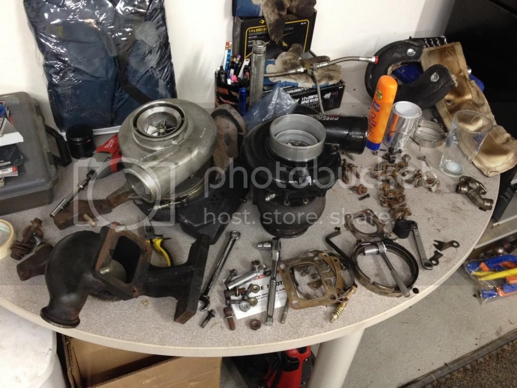

It was gated into the atmo. I am about 99% sure there is no issue with the oiling. I don't really know why it chit the bed, but it is what it is. I just know that it needs to get fixed. Just not 100% sure what will be going back into the truck. I plan on pulling the turbos Sunday if I get the time.
