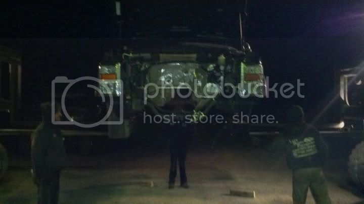

My headgaskets were blown, I figure I should add a few more things while we were in there.
New Mods:
arp studs
stock gaskets
precision wastegate
batmo wheel
rudy's ported rails
rudy's stage 1 valve springs
mbrp ic pipe
dirty diesel intake horn
mbrp 5" exhaust
gooseneck hitch
My buddies shop does primarily dodges, so he doesn't have a lift, but he does have fork lifts :rockon:. At last years rudy's dyno day I may 556/1060 with a mini maxx, intake, dpf/doc delete, airdog. How much do you think I will make know?

Looks good, I did the same, deleted the egr hoping that was the puking issue, same shoes as you. I ended up tearing it down as well. I was all for the two forklifts but my cousin who helped me didn't want to so we ended up borrowing a lift and then bringing the chassis back to his shop where I tore it down just as you are doing.
