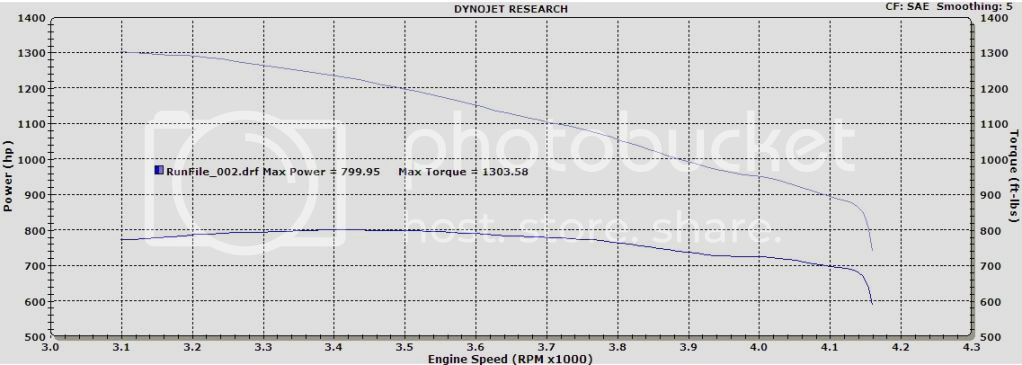

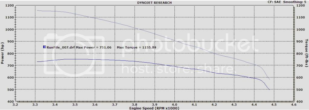

Here are the dyno graphs sorry for the delay. The first one is extreme race, which was way to much fuel. The second run was using extreme street which was slightly better. I will load the videos tomorrow when I can use my computer at work.

As far as turbos goes the kit I sent Mikey had the 75/83/.90ar which is our normal s475 kit
Me and nick are running the race setup which is 75/87/1.0 or 1.10 which picks up alot of horsepower and lowers bp
I never once had a problem with backpressure but there are some difference between the two trucks
