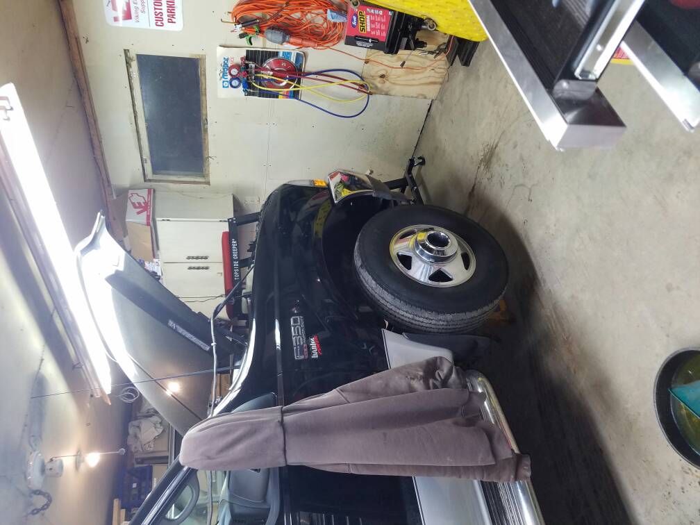

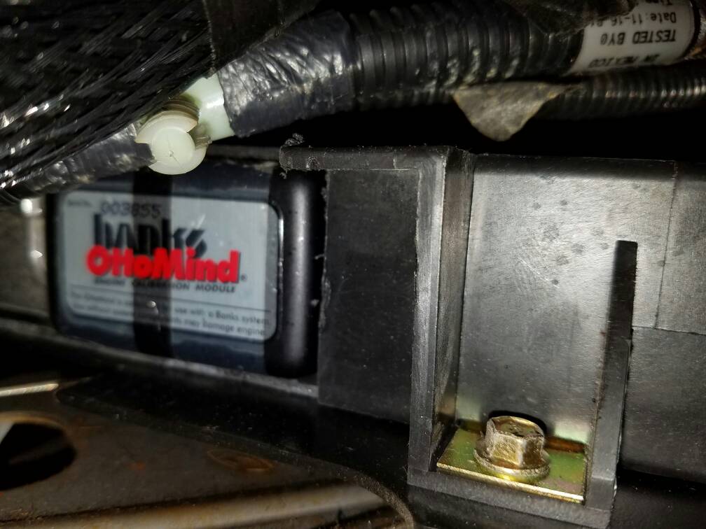

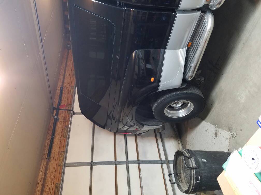

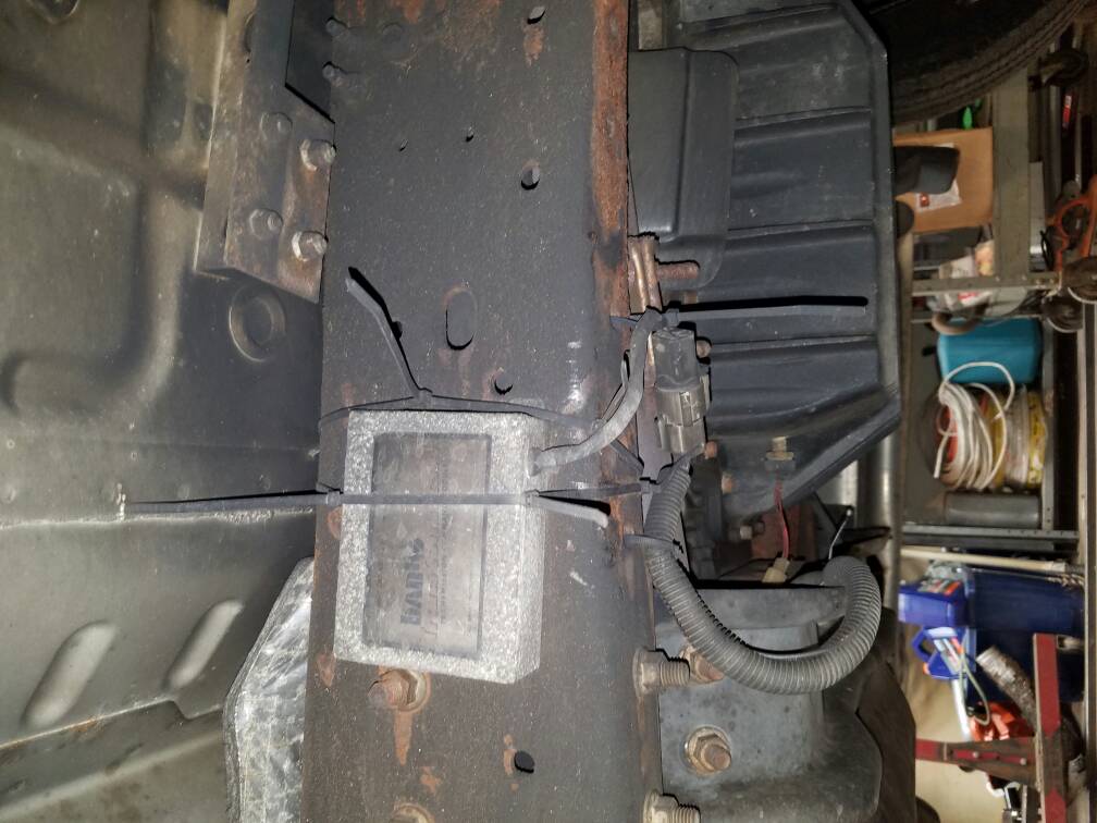

View attachment 46399View attachment 46400View attachment 46401View attachment 46402
Sent from my SM-G930V using Tapatalk
Anyone know why when I upload from my phone using tapatalk it turns the pics sideways?
because you have to hold your phone sideways to take a pic. not up..
also, I'd be surprised if you have more than stock injectors.. sd's run quite a bit better then an obs..

Yep, I think it has stock inj's now that I had the valve covers off. I bought a vc from Ford, one of the competing dealers that sponsors FTE and a few others online is right in the twin cities so I get 20% over cost. I have a hydra for it but haven't had time to pull the banks chit off yet, looks like I have to un-modify the trans harness to get rid of the trans command.

Have you ever ***ked with the dually marker lights? I haven't been able to get them to snap back in.
heavydoc
Mar 13, 2016
644
Cruso, NC
My right red one is like that, if the plastic clips aren't broken try rebending the metal retaining clip.
