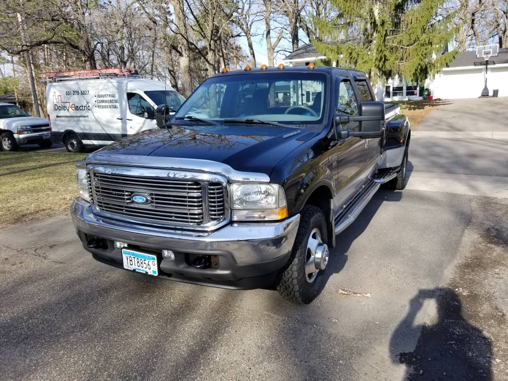

My new to me tow rig: 2002 F350 Dually

Quick run down:
2002 f350 Lariat crew cab long box dually 4x4 7.3L auto, little to no rust
Manual transfer case and hubs
Banks intercooler cac pipes and big head waste gate actuator
Adrenaline hpop
250/100 full force injectors gone through by full force 15k ago
Head studs
Irate competition valve springs
Rebuilt oil cooler
New Ford oil pan
New Dorman exh manifolds and bellowed up pipes
Resealed the top end (fuel and oil orings)
Stock fuel
Stock trans
Hydra with G******** tunes
New ball joints, front wheel bearings, axle u joints
New rear u joint, pinion, and pinion seal
New front tires 235-85-16 bfg ko2
Rear tires 3/4 tread 235/85/16 bfg ko2
New el cheapo shocks all the way around
Under dash gauge pod with new EGT gauge, boost, trans temp.
Brake controller
Double din pioneer DVD player with remote
Draw tite 25k turnover ball
Bed rug
Access tonneau cover
Asking $12,000
