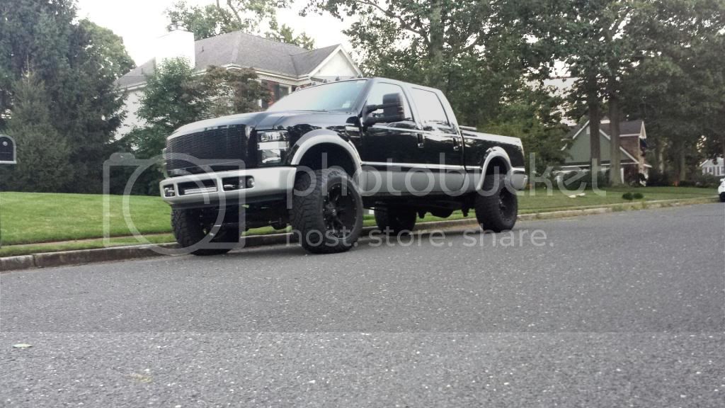

Got bored and played with my buddies new galaxy s4 and took some pics of the truck. the paints filthy but it give you a little idea of the height of the truck. And my crooked light bar :doh:
