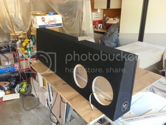

I'm slowly putting together a small system for my truck.. Nothing major... So far I'll be running 2 Skar VD-8's hooked up to a Powerbass ASA600.1Dx amp running 600 watts @ 1 ohm.. In time I'll slowly start to work on the high's and get them situated but that'll be awhile.. Here's a pic of my custom built box, compliments of Cscstang Customs out of California.. Its 1.35 net cu.ft tuned at 35 Hz.. I should get the box by Tuesday or Wednesday of next week

Box came in this morning and I got to work on installing the 8's and getting it all wired up to see how it sounded. I'm very impressed with it.. Hits very hard for 2 8's. Box is built top notch.. I'll take some pictures tomorrow.. cscstang customs did a terrific job on the build. Now to wait on the dynamat to come in and install some on the backwall.. I'll get some pics when I do that..

I like! I had 2 ID 8's in a similar ported box with a JL 500/1 on them in my last truck. I was shocked at how well that setup worked.
UNBROKEN
2,788
Nice enclosure. I'll add them to my list of people to call. I need 1ft^3 sealed for a 12.

I'm having a bit of an issue and trying to decide how to handle it.. The subs are moving so much that they are rubbing on the back of the seat in a cpl spots.. Already have a tiny bit of damage to the foam on the subs.. So now I'm trying to decide on how I want to tackle this.
UNBROKEN
2,788
Easiest fix if find some cheap grilles that fit. eBay is full of them.

Update.. drilled all new holes in the seat frame and moved the seats up roughly 3/4 of an inch and now the subs do not touch a thing.. all is good.. did order some grilles for extra protection. When they come in it'll be one more tear down.. I'm very happy with the sound that these lil 8's put out.. man. They hit hard for 8's.. unbroken.. I was gonna give u my number bro and was gonna get as many measurements as I could with u on the phone this morning but I was to late getting to u.. sorry man..

so those are 8's or 10's?
that box looks huge for those, but then again, when I had my one solo 8 the box was huge and it did hit very hard. i'm sure things have come along ways in the past 10-15 years since I played with audio.
djr4x4
Mar 29, 2015
365
Southeast Texas
They are 8's and yes, the box is ported which is why its so big.. 1.35cu.ft.. In a sealed enclosure they don't need near as much as this..
