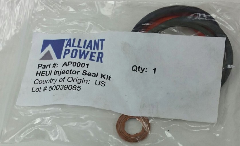

I have a few new packages of alliant parts here Mr Armstrong and they all say "made in china". Is this a new development? I seem to think I would have noticed this before if it was going on.
golfer
1,209
our Alliant o-rings say Country of origin: US on them.
golfer
1,209
no idea...on the wiring/gaskets. we only recommend Motorcraft for those items.
