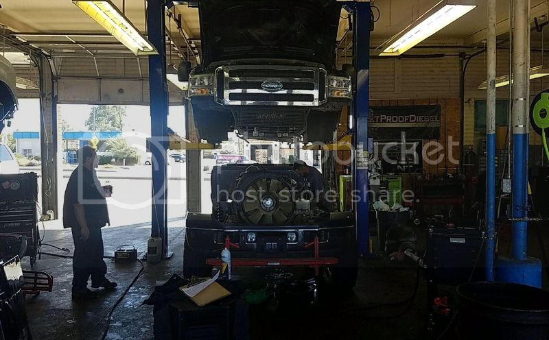

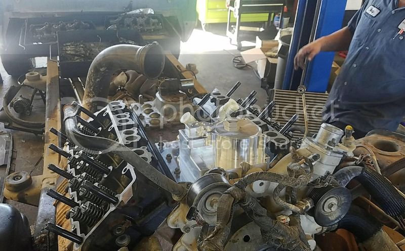

On my way home it overheated and 3 injectors went LOL! so it went to my friends at Arizona Affordable Diesel Techs for a bunch of stuff i will list below. Here is pics of it.
I got it back and took it on a little crazy trip to glamis that was the worst trip of my life. But, thats another story. Truck was amazing. At this time the truck had bullet proof egr coolers and stock turbo just all the bullet proofing was done. I got new wheels which i always get.
