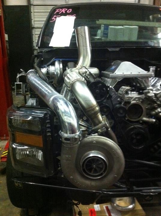

Why does the small charger get spooled first on the hot side, but get fed air from the big charger? We can follow the flow and see how it works, I was just wondering why its plumbed like this when 01Platinum and I were talking about it.
This picture that David posted has a clear view of the plumbing

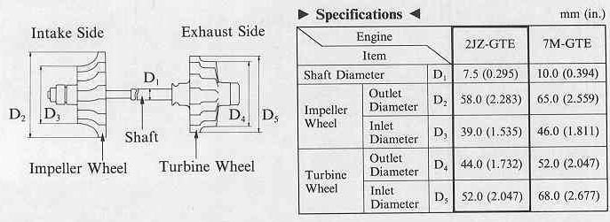

D2 is called the "exducer" of the compressor or intake wheel.
D3 is called the "inducer"
D4 is called the "exducer" of the turbine, or exhaust wheel.
D5 is the "inducer".
On both the compressor and turbine wheels, the smaller diameter is called the "minor" and the larger is called the "major".
Yeah the small charger is used to help spool the larger charger. This is why it is bolted or collecting exhaust from the manifolds. The exhaust side of the smaller turbo helps drive the larger turbo. The larger turbo then feeds air back through the smaller turbo where it is compressed more or compounded.
