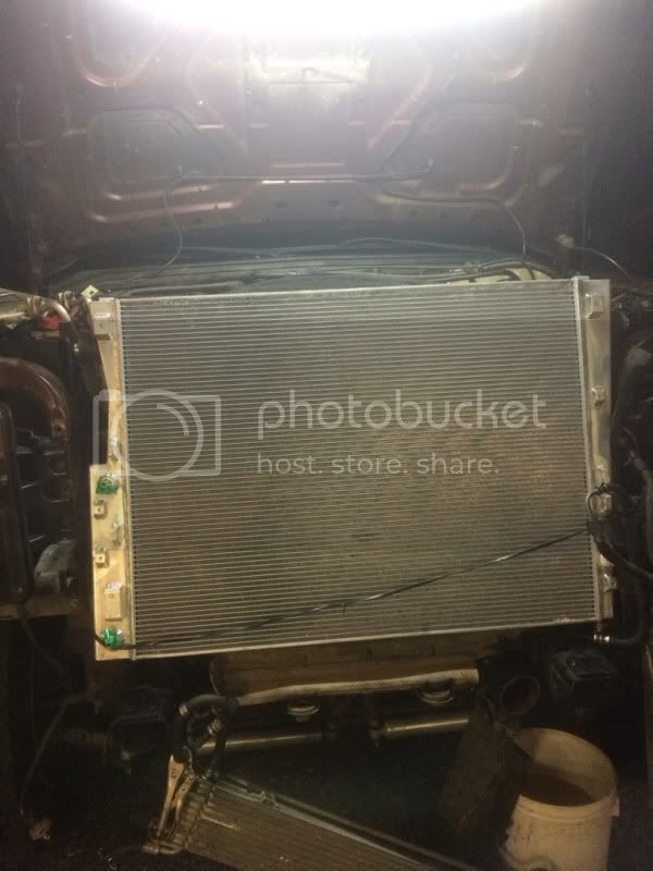

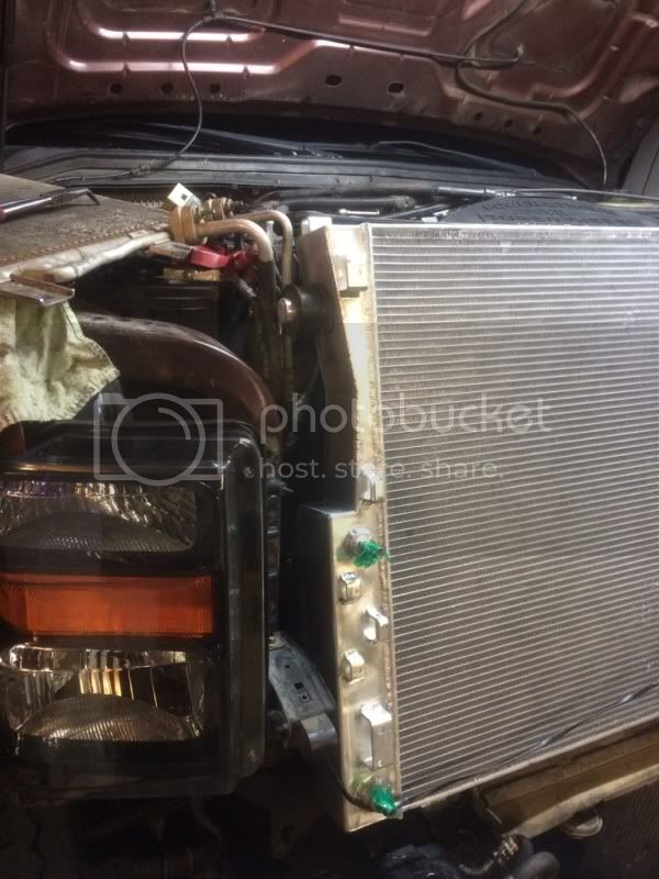

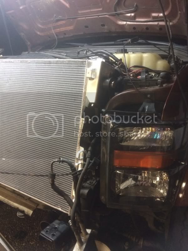

Update, the 6.4 radiator is installed and testing. From the other thread in case you haven't seen it. Thank you Nick for all of your help and input. Guys like you and communities like POWERSTROKEARMY always blow me away. I don't even know your last name but you're willing to go out of your way to help in anyway you can for the good of other Ford truck owners. Thank you!
So I finished it up yesterday and got it all in and running. Not expecting it at all but right off the batt I noticed cooler temps by about 4* cruising down the highways and while pulling grades. I normally run about 200 running down the freeway load at 60-65 and I am at 200, now after the radiator I am 196 rolling down the freeway and pulling about 12k, on a grade loaded the same I do often I normally get to about 212 and now I am around 208 with oil temps being about 1-2 degrees lower also. Over all I am extremely happy with the piece of mind this gives me knowing that I wont have to worry about the stock plastic end tanks leaking leaving me stranded some where. I also noticed a 4 degree drop in trans temps thanks to the bigger internal cooler in the radiator, must be a theme here with 4 degrees lol. Peter has been a hella of a guy to work with and I am excited to see what he will do with the intercoolers too!

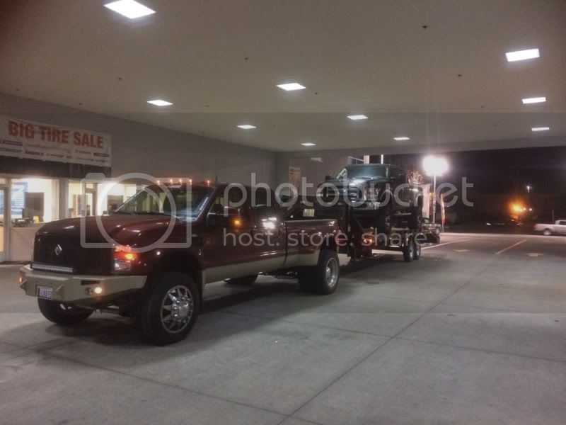

Here was my first test with it last night just a small load.
