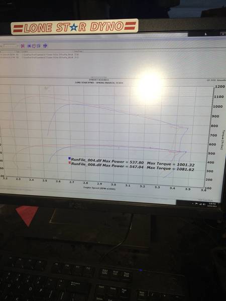

on the dyno today it gained 10hp / 80 tq with no other changes on a 2015 .
factory 537/1001
No Limit 547/1081
and substantial increase in throttle response and low end responsiveness .
PIP performance tune , no limit intake, exhaust .

we went for a cleaner finish, hoping we would be first to market , we couldn't be happier with our unit !

im assuming that gain is from better flow but did you monitor intake temps and egt's to see how much they dropped? badass either way.. gain is gain!

I will be monitoring all the temps on mine as well as seeing what the gains are at around 6-700 hp mark are. I assume the hp difference will be greater with more demand.
I will report back once we get the dual fuelers on and tunes ready. We are going to switch the IC on the dyno.

so far cruising egt has dropped but little to no drop on the dyno. water temp, is well , water temp .
