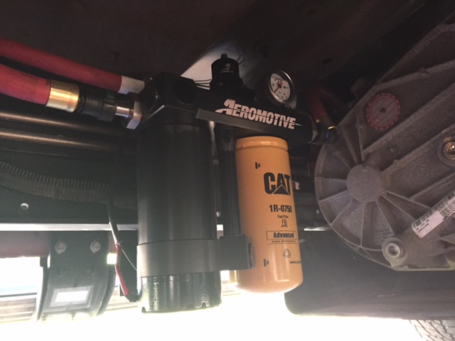

I just had the opportunity to have my truck used as the test truck for the new Aeromotive Lift Pump for the 6.4
The Aeromotive pump has a brushless motor and is very quiet. Everything from the massive 3/4'’ baffle to the wiring harnesses are top notch.
I'll post up numbers for any hp increase and mpg results as I get them.
Just wanted to share that there will be another option for 6.4 guys soon.

Looks like a very nice kit. I wouldn't waste my time with power or economy tests though. I did the testing when I went from a weak factory pump to the airdog 2 lift pump. Verified lift pump and injection pump psi before and after. There was no power or economy difference. I did it hoping I would better maintain rail pressure, but nothing changed except for lift psi at the cooler going from 2 to 10 psi. Hey; as long as it proves to be reliable as the other aeromotive products, I'm sure it'll sell itself. It looks great. Thanks for the initial review. ;)
