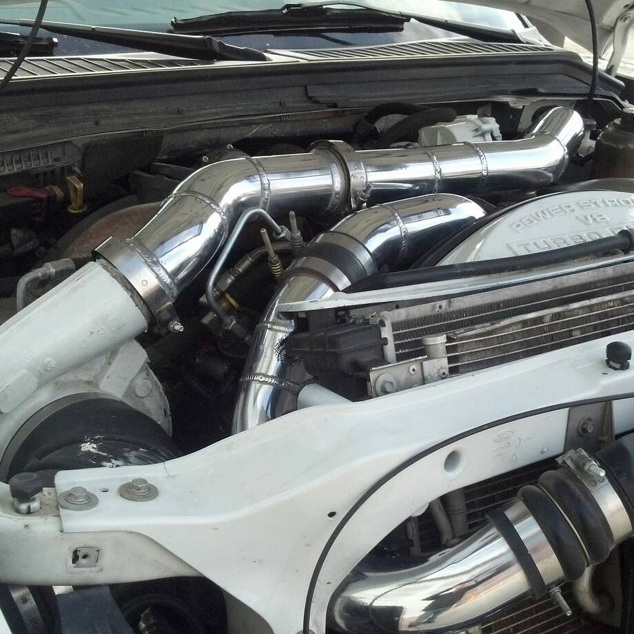

Thinking About painting the middle compressor covers white. What's everyone's thoughts on that and what rattle can paint have you used that works the best?

White goes well with aluminum....

No but I have seen rattle can look just as good
Ask mike@hallers what he uses it looks great but I think he uses the engine enamel

2 59mm & 2 72 mm... I'll give the white engine enamel a try tomorrow. Anything special you use to clean the housings before spraying them?

Wax and grease remover. I also like a self etching primer as well as a primer sealer, all in ratle can, not totally necessary but I think it helps bond and smooth
