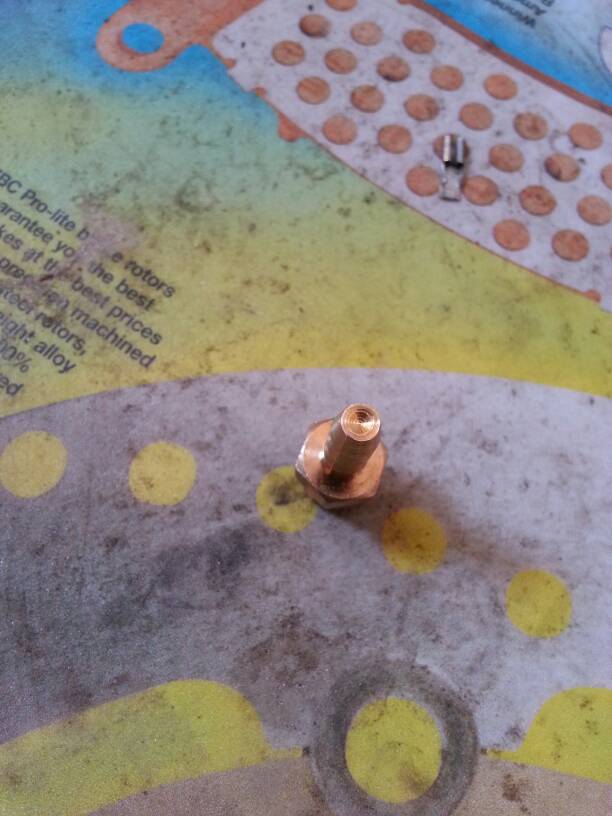

Found why my boost gauge was inop.
The truck is running suprisingly clean. I am starting to wonder if I have a fuel pump issue. Completely cleaned up 2ms so today I bumped it up to 2.8ms and its still pretty clean.....but she's moving out so I think I'm doing okay.

LOL I have never seen a barbed fitting that did not have the hole in it!! I have seen lots of wacky nails and screws Bolts, Nuts But never that!
2.8 with 400/400?? Do you happen to be able to take live data to see if it is that actual??
That is still VERY good!!
