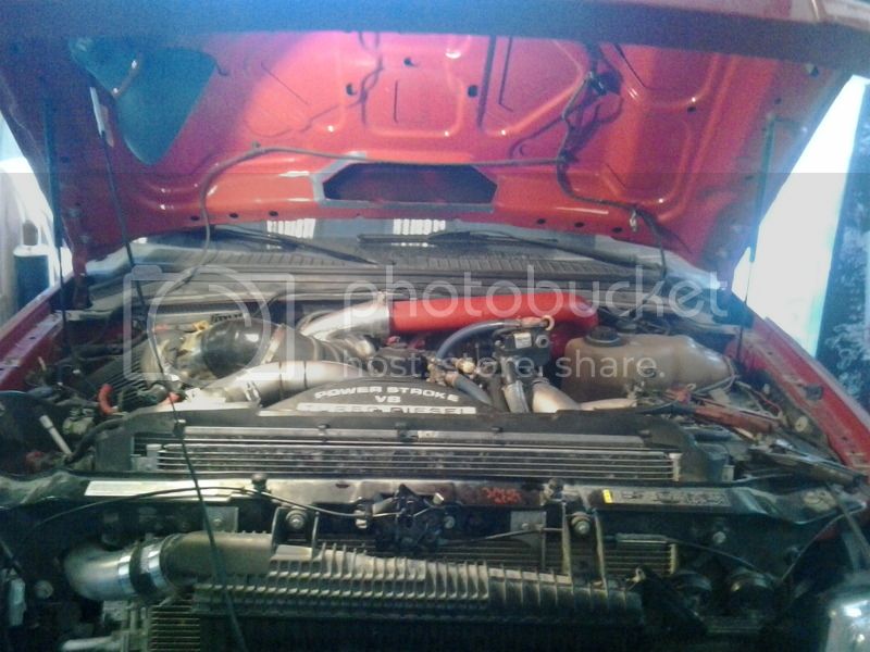

This is what I had to do. Mine is all one piece from the boot to the filter. I ended up using part of a 5" 90 and a bunch of pie cuts.
Somd_6.4
Feb 21, 2016
105
Just needs some powder coating but that can wait. Time to test testing Thursday night.
