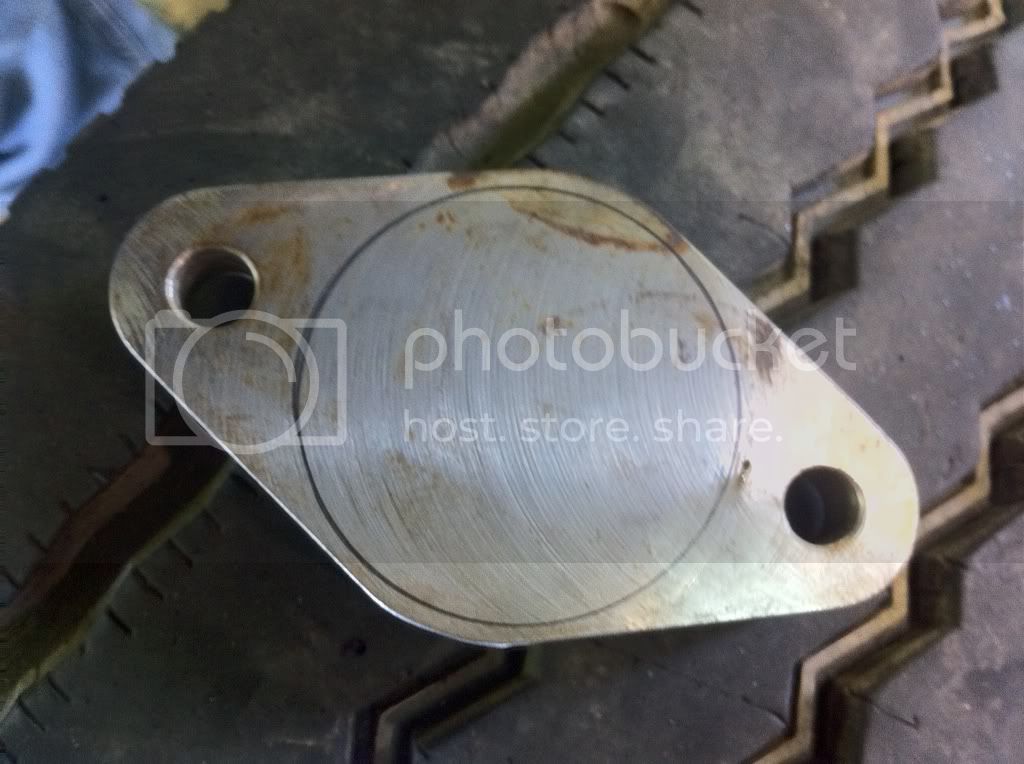

I switched from a full egr delete w/ wastegate to block off plates. Strange thing is my EBP hasn't changed but my level of boost seems sluggish to build.
I'm thinking boost leak on my uppipes.. Here is the plate I got from BgBlkDdge..
Not too happy w/ it.. He said he hasn't heard any issues..

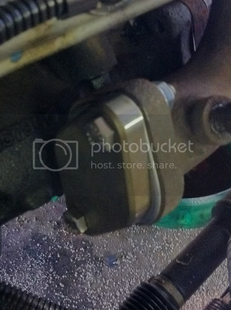

Thanks for the help guys.. I will snap a pic of the pipe tonight and see if we got soot. It's still 98 degrees out so i'll let the concrete cool first haha..
