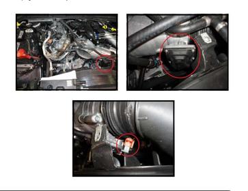

How many connectors, besides on the exhaust, should be unplugged? The only one I have unplugged I'd the orange one that connects to the EGR.
Mar 7, 2014
628
Central Illinois
You're missing one under the hood. You need to disconnect the other orange plug that connect to the intake throttle valve as well. Also, as far as the exhaust sensors go, I unplugged every connector that went to the exhaust and left them off. I also removed all my modules that the sensors were connected to. There is a NOX module and two sensor control modules. But I would start with seeing if unplugging the intake throttle valve sensor makes any difference.
