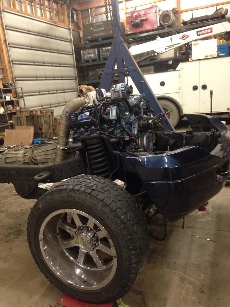

Did a little mock up. Hopefully I can get it to work without any issues. If not, I'll use what I can on the 6.4.

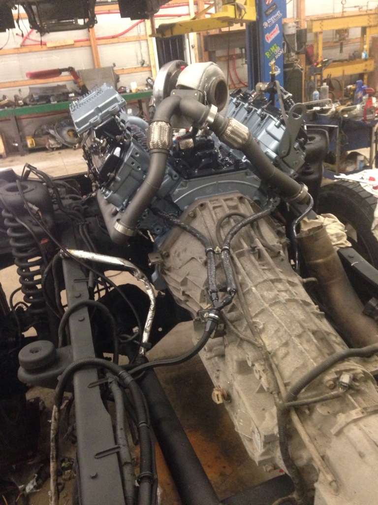

Engine is back in the frame after a complete reseal, RCD cam, new lifters, RCD pushrods, o-ringed heads, extreme studs, bpd water pump, and a few other things. Decided to paint everything while I was at it.

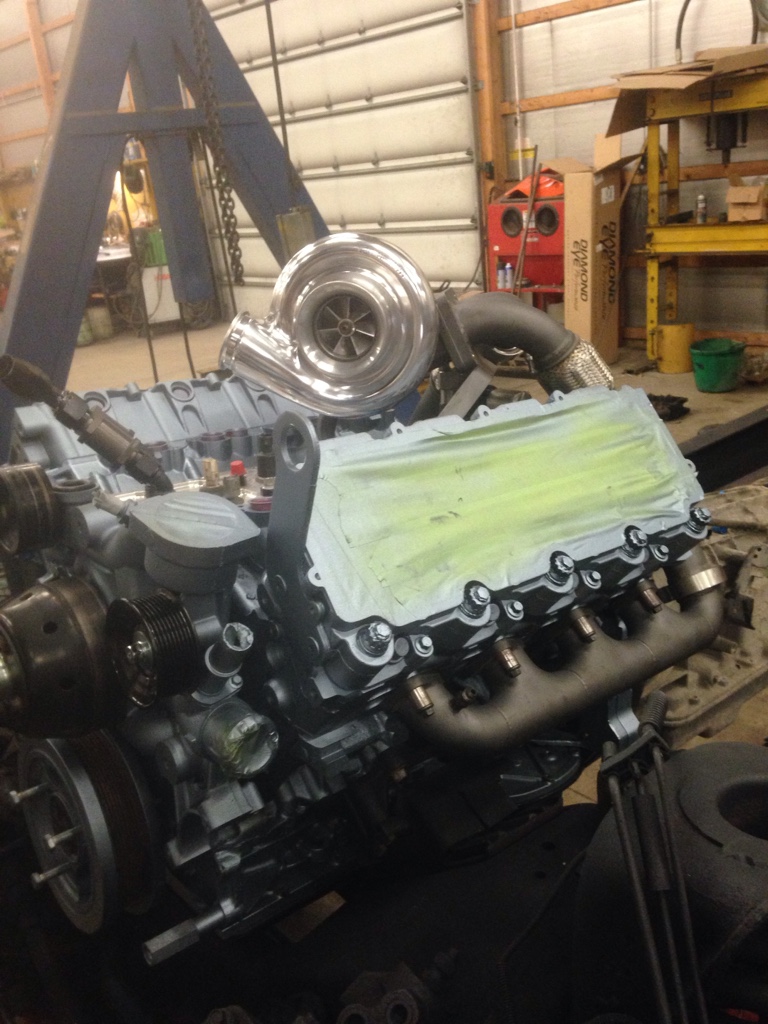

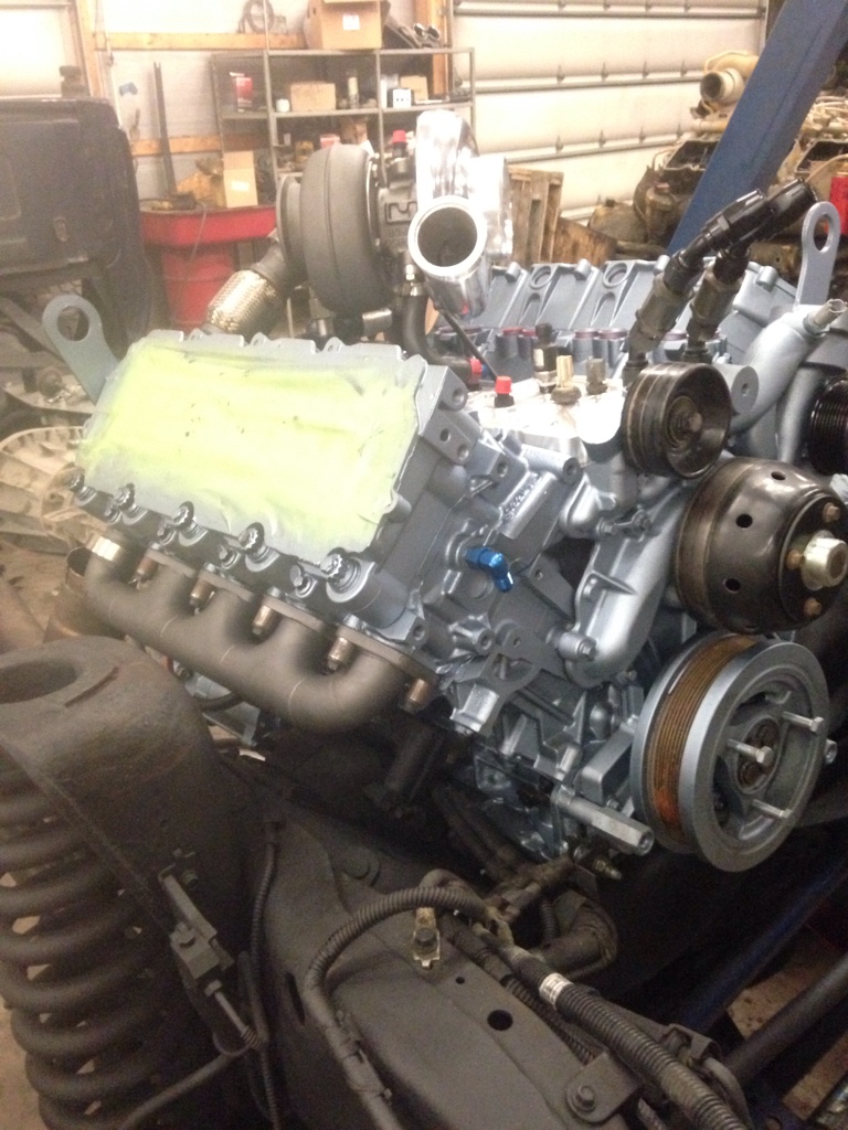

Didn't have much time over the last few days. Got the beans sump installed, and the factory pickup foot removed so I can return through it. Also got the MPD log manifolds and v-banded uppipes on, along with the HTT 364.5.

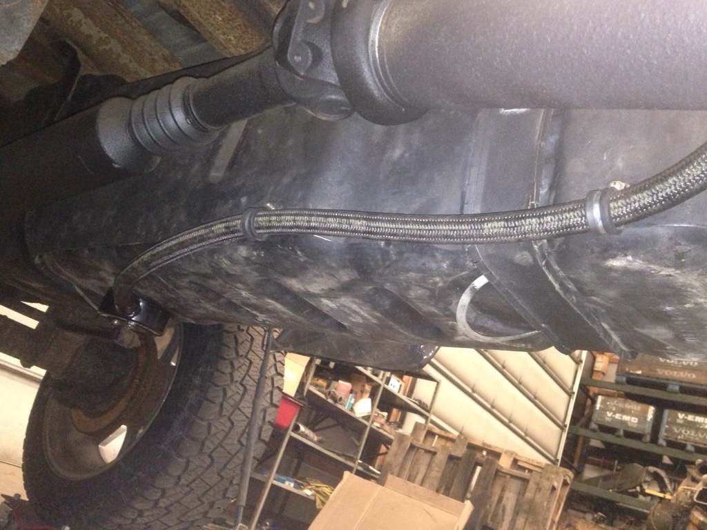

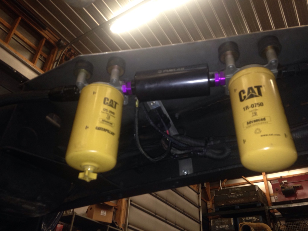

Still waiting on an intake manifold, running out of stuff to do waiting. Supply side of the fuel system is done now also.

Mind me asking what's kinda pump you got going on there with those CAT filters? My boss mentioned something to me like that once it's very interesting.
