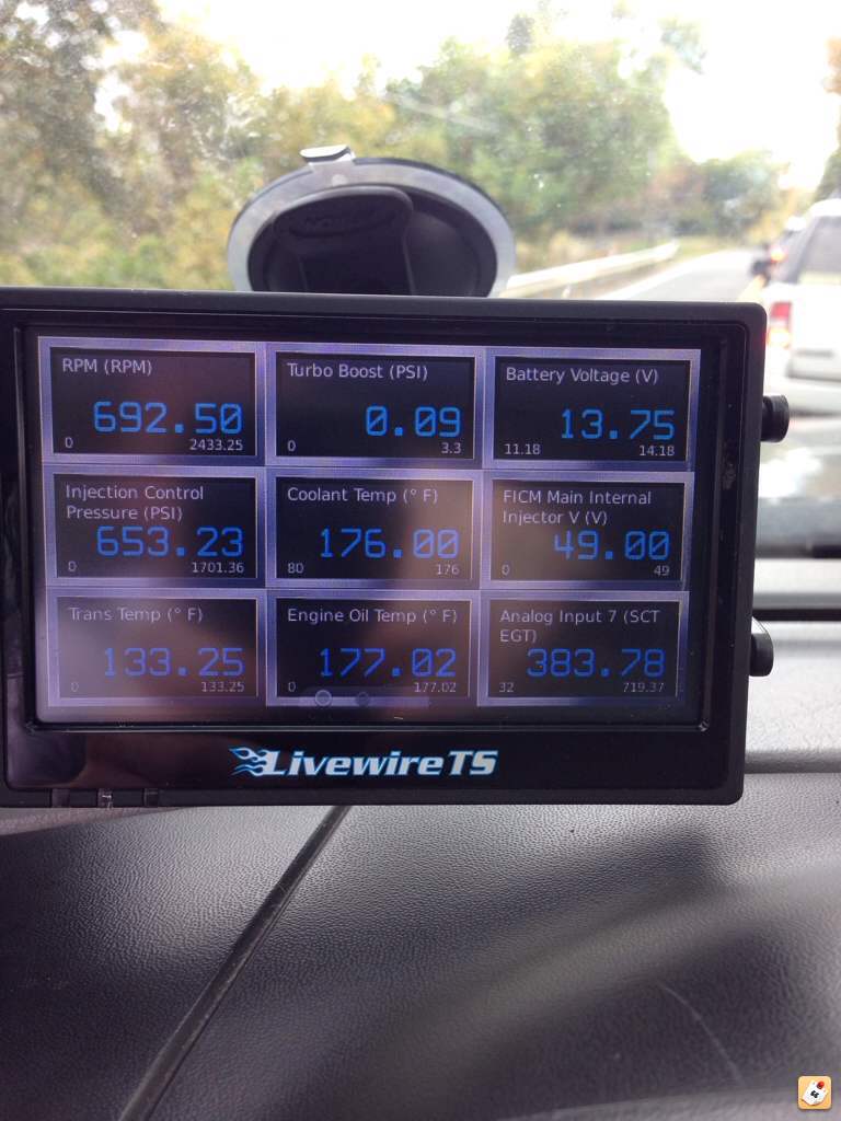

Like I've been driving 10-15 minutes now at 55 and it's +-1 but not up to temp

My temps are 204-207 now moving in 5-10 mph traffic so I guess they aren't super low anymore. Adam said were gonna throw a tstat in first to see if that doesn't help the deltas

It should raise both temps...
IF the oil cooler is good, regardless of coolant temp, oil temp should be no more that 15* of that.
For example...you're seeing 175* ish coolant temps now with a low Delta...which is fine, other than the tstat being stuck open.
With a new tstat you should see coolant temps around 190*-200*..with oil temps within 15* of that.
What ok getting at is provided your oil cooler is in good shape, regardless of coolant temp, oil temp won't be very much higher.
Like I said a few posts back, change the t stat and go from there. I think you're good to go after a new thermostat

yea hopefully it's just the tstat but I guess we will see when we change it. I have seen as high as 15* once but never over. A little close for comfort though

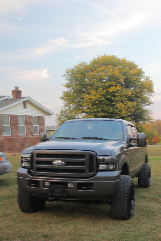

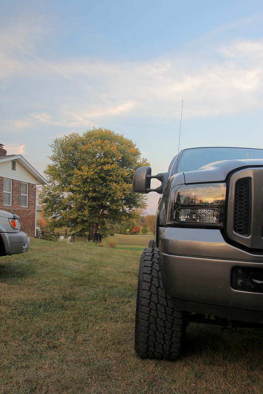

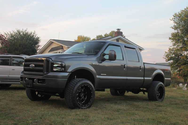

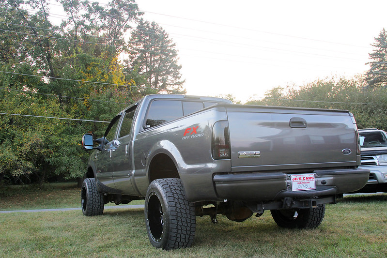

Anyways, here are some quick pics I took when I got home tonight. Sorry a few are blurry they looked good on the little LCD on my camera
IMG_1830 by o2shootthej, on Flickr
IMG_1831 by o2shootthej, on Flickr
IMG_1832 by o2shootthej, on Flickr
IMG_1833 by o2shootthej, on Flickr
IMG_1834 by o2shootthej, on Flickr
IMG_1835 by o2shootthej, on Flickr
