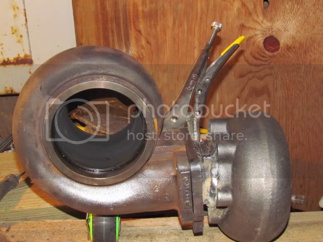

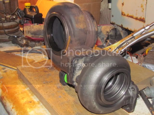

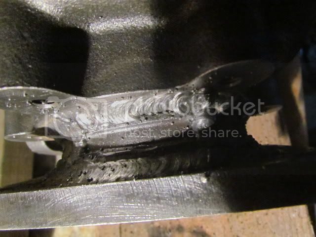

Here is what I did today. I got some time off!!

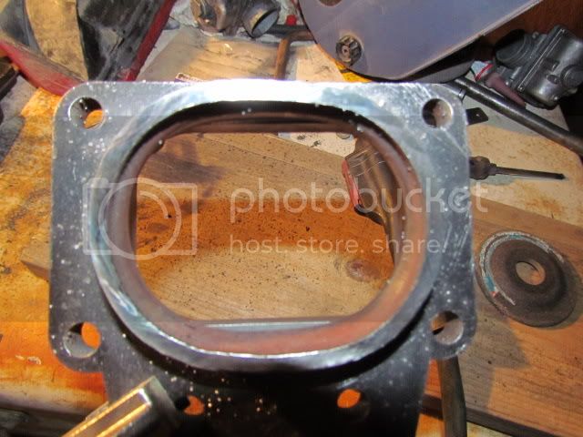

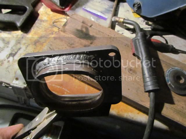

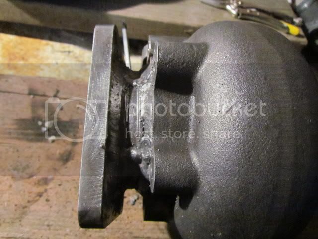

This is the flange and itermedite pipe to feed and bolt the S4T to.
This would be the flange welded to the GT42 Exhaust housing..
See the two holes at the bottom of the flange?? I am going to build a mount that bolts to the engine block then bolts to the flange to support the S4T.
This is what the two housing will look like put together

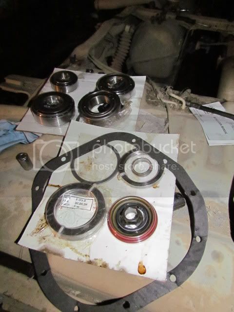

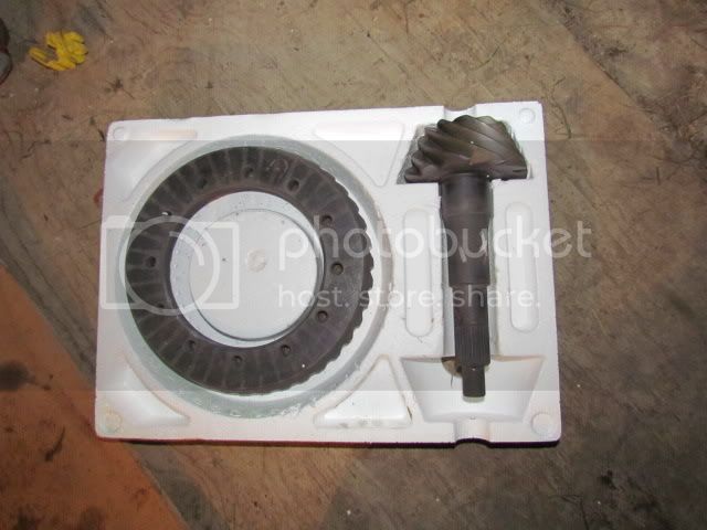

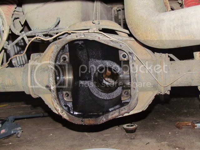

And I got the Rear axel gutted the rest of the way.. everything is ready to go back in, I just need the tourque specs for the nut that holds the pinion in.. And for the twelve bolts that hold the Ring gear on..
new 3.55 Ring&pinion Gears..
The complete axel bearing and seal Kit.

All I need is a half and inch more of room and I could bolt both housings in..
So I bought a two inch body lift so that should give all the room I need...
Sorry about the welds:doh: I was haveing a little bit of trouble keeping the wire comeing even..

And I put new Brake drums and shoes and all new break springs on to..
I have a "new" axel well rebuilt axel..
